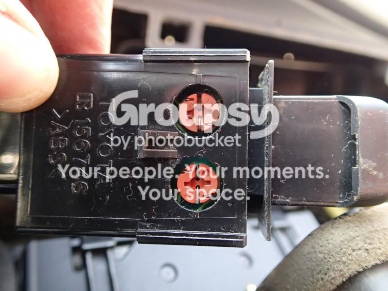

96 4Runner
Location of bulbs in
Hazard switch (1)
Defrost switch (2)
Use a screwdriver to turn a quarter turn and take straight out.
I found the bulb in the switch from my parts truck, so it basically means that every one of my 3rd gens has had burned out backlight bulbs for those switches. Thanks for checking. Next time I pull that center bezel (to hard-mount my CB, probably) I'll replace those bulbs. Thanks.

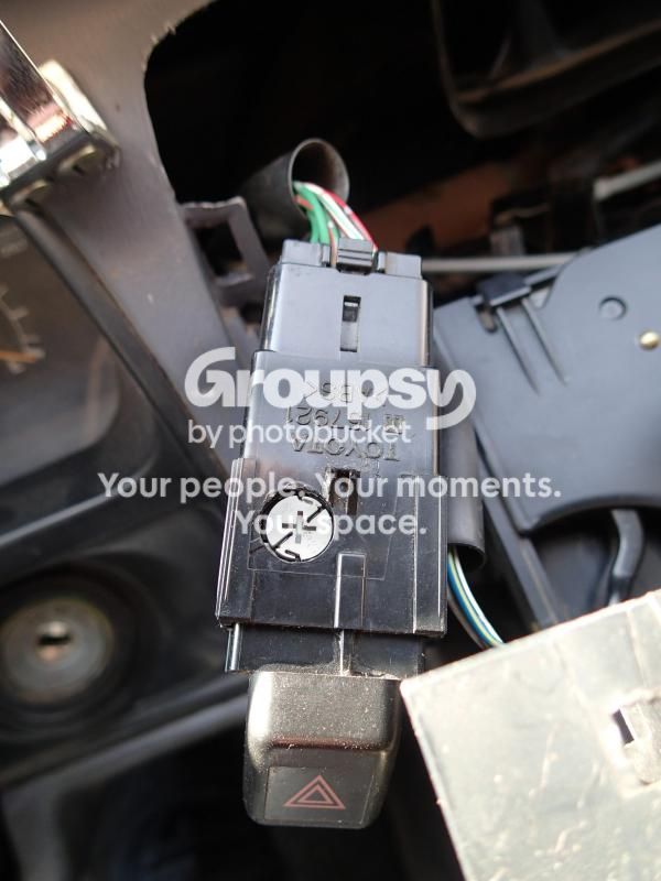

Part # on hazard switch bulb '98 T4R SR5
Hello everyone. I'm new to the forum and have been recently trying to rebuilt the interior on my 98 SR5. It has got the defrost switch, hazard switch, and the clock all burnt out over the years of use. I have successfully found replacement defrost switch and clock on eBay that work (meaning they light up with headlights on), yet the hazard switch I bought from eBay did not light up. I consider myself unlucky, so I try to get the light bulbs inside the switch instead. I found a Honda light bulb that look similar, but today when they arrived I found that the bulb is too small to fit into the switch housing.
So, does anyone know how to get the light bulb separately? Or do I have to buy the whole switch, which would be the third switch in my possession. Part number would be nice since I had no luck searching the Toyota parts page.
Toyota part number 84999-10850
1999-2004 Toyota Bulb 84999-10850 | Conicelli Toyota of Conshohock
Plenty of aftermarket stuff out there too. Search Neo-wedge T3 OR Neo-wedge 8mm base bulbs.

My hazard switch no longer back lights when the headlights are turned on. I have a 1998 and Toyota says PN 84999-10850 does not work with my vehicle. I'm doubtful, but does anyone know if there was a different PN for pre-1999 vehicles?
Also is this a standard bulb that I could get off the shelf at an autozone, or is it proprietary?
It's been a while since I worked on mine, but on my 2000, that bulb is a Neo wedge, I'm pretty sure it was a T3, but it might have been a T4. Because of the location and direction of the light inside the switch, don't use an LED with a single led on the top or it will barely illuminate the switch. It's best to just use an incandescent, but I've seen more expensive Neo wedge LED's that have LED's pointing in multiple directions that might work if you really want to try it. This is the style I tried as a replacement before I went back to the original because it didn't properly illuminate the switch. It fit fine, so that is the base style you are looking for assuming the bulb is the same on yours as it is on a 2000.
