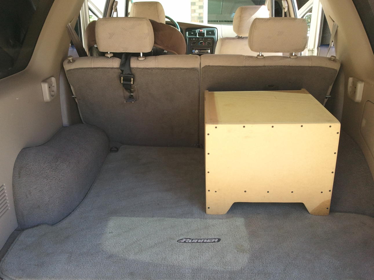

This is my solution for something that will fit behind the third row, hold a sub, and hold tools. I originally wanted it for an 8" or 10" sub but I got a 12" for free so in it went. Works great and uses the existing tie downs to keep it secure.
I have the plans in SketchUP if you're interested in building it.
So I'm assuming you scoot it back when you put the third row seats up? So that would place the enclosure right up against the door. So does that create any issues?
Yes, I left enough wiring from the amp to the box allow it go move behind the third row. There is still a good 4 inches between the rear of the box and the hatch and I have no issues. Although I rarely use my third row.
