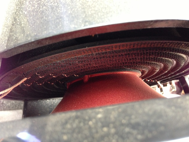

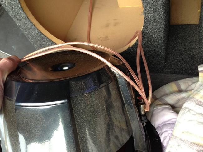

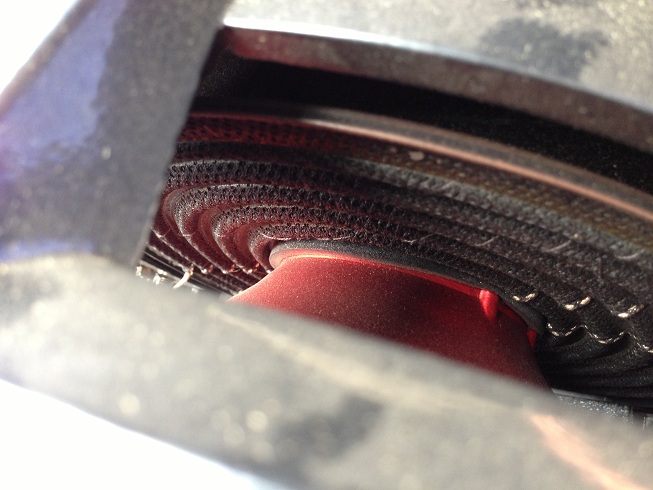

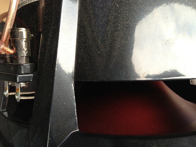

yes pull it out and take a pic of how its wired, it may not be connected properly, ive had wires come out before, also take a pic of the inside of the sub, under the cone.. the spider, it looks like wavy cardboard usually, so we can verify if you thermaled the voice coils. also.. your setup can only be wired to 2 ohm or 8 ohm load.yes it is 500rms at 4 ohm, so theoretically about 700 or so at 2ohm(what you have it wired to) but those amps are over rated so its more likely about 500rms at the ohm load u have it at.
Subs are dual voice coil, take the sub out and check how its wired on the back and use the link i showed you, take a pic for us to use, dvc2 or dvc4.
Here are the pictures. I only took out the left sub.
i
i would also pull out the other sub to inspect it and verify its connected and wired properly. the two voicecoils are wired in parallel , when you connect easch sub to your amp its also making a parallel connection giving you a 1 ohm load. your amp is stable at 1 ohm. so your realistically around 7 or 800 rms to the pair which is perfect if theyre 400 rms each. your voicecoils, spider and tinsils look good from what i can see. like i said i would pull the other sub out too to check it out. i dont see anywhere in this thread anyone asking you exactly what its doing.. when it cuts out, see what the amp is doing, is it goin into protection, does just one sub cut out, is the amp stAY powered when they cut out. from here we can know whether its power, protection, or sub failure.
also , i cant see in the box, but is the box seperated into two individual enclosures, or can you see the other sub thru this subs opening. if theyre not seperate enclosures, you dont want to play just one sub. the larger enclosure with out the other sub running also can ruin your good sub.
Wired the subs you have now the same way, dvc4 to a 2ohm load in each speaker terminal, might need to just clean up the wires on the terminals of the subs and jack. Then it should bring the load on the amp at 1 ohm, this will give enough power. Maybe the amp dont like 1 ohm, so u can try the 4 ohm load too, make each sub at 8ohms. Less power but safer. Isf sbould be in like 32's.

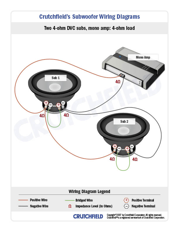

FIRST

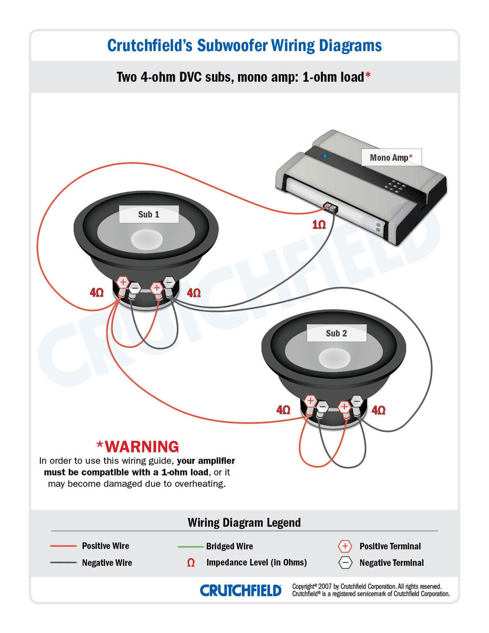

* Based on your speakers (two DVC-4 subs) you will be presenting either a 1 ohm load or a 4 ohm load to the amplifier, assuming you use both.
* Look at the diagrams below. Make sure you are correctly wired for either the 1-ohm or 4-ohm load.
* Assuming you fixed your wiring setup, try to create the error again.
* Switch between the 1 and 4 ohm setups (ohms presented to the amp)

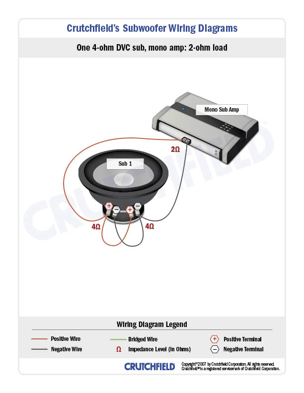

About your subs .... if I read correctly, your SUBs are DVC-4.
To get what you desire, 450W RMS per sub (amplifer: 900W at 2 ohm load) you would need to wire each sub to present a 4 ohm load, then wire dual subs in parallel to present a 2 ohm load to the amp.
==== BUT ==== You cannot wire a single DVC-4 subwoofer to present a 4 OHM load.
Therefore you cannot present a 2-OHM load to the amp with those two speakers.

Crutchfield Wiring Diagrams (free)
Subwoofer Wiring Diagrams
If nothing else works just wire each sub to present an 8-ohm load and then present those in parallel to the amp.
The amp will see 4-ohms and you will get about 450W RMS out it, not 900. So about 225W RMS per speaker.

So now that we know these P3's are dual-4 Ohm (DVC), you should probably wire them series-parallel for a 4 Ohm net load at the amp IMO. Any less than that (options are 4 Ohms or 1 Ohm at the amp) is simply taxing the amp to its limits (thermal and current limits). The amp has (3) 30-Amp car fuses - so there's no way it's pulling more than 90Amps - I'd say the 4Ga CCA is still more than adequate for this amp at any impedance load...

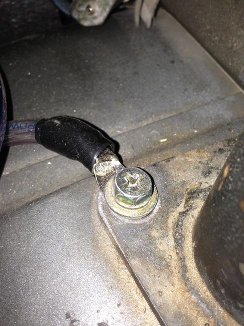

Moving the ground to a direct connection to the chassis/body is also a good suggestion (thanks for posting pics of that as we hinted at on Page #1). You also need to check that your Battery-to-Chassis ground is of sufficient gauge. The stock ~6ga ground might squeak by, but I'd go with at least a 4Ga here. Measuring the voltage drop "at load" (also as suggested on Page #1) would also help determine if the wiring is up to the task...
