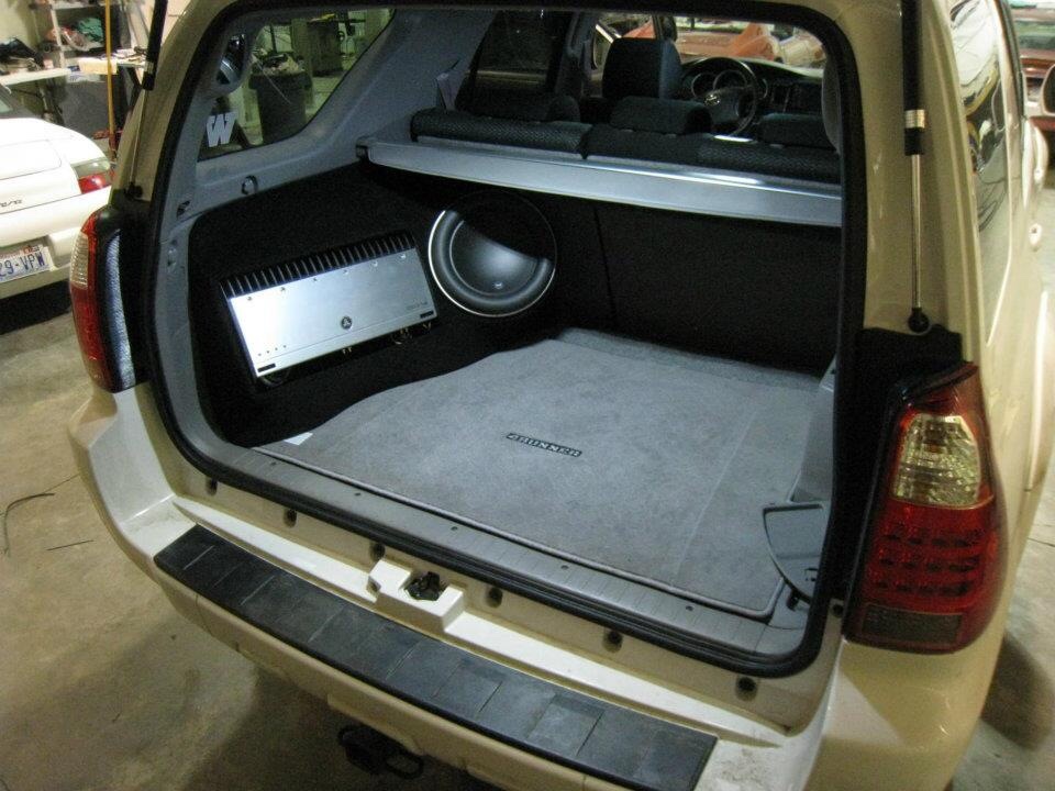

I had a shop do mine. I had already purchased a 12w7 (thinking bigger is better) but the guy who built my enclosure said he could make a 10" sound louder than my 12". Plus it wouldn't have taken up as much space but I also didn't want to spend more money and hang on to a spare woofer. All in all, sounds great and love the jl and finish
Looks awesome
That amp is Huge, what does it power and how much ?
