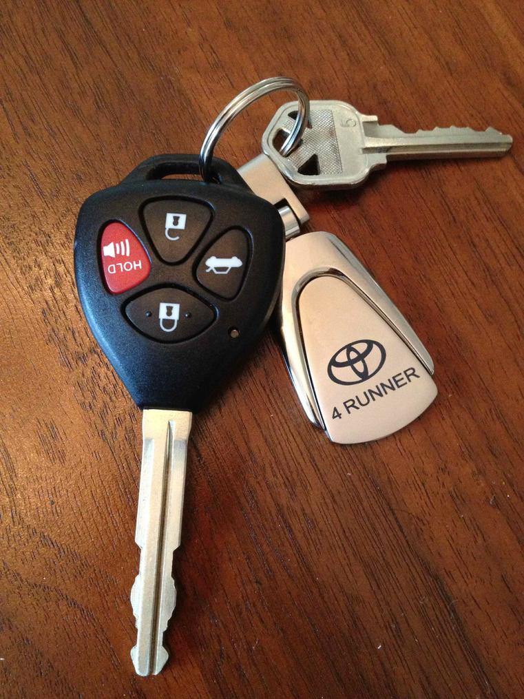

Thanks to Hobson & this forum! Key arrived quickly with Toyota logo. Ace charged $0.75 to cut the key. And programming worked 1st try for both remote & immobilizer.
I got mine to work after a couple tries. I like the new look. I bought the keychain for $10 at the dealer. Locksmith charged me $10 to have it cut. The Locksmith charges $95 to have it programmed. Thanks again guys!
UPDATE: The red hold ''panic'' button does not seem to work like my old fob. I press and hold it and it only beeps once. Anyone have any idea as to what the issue is? Fob or programming error? I really don't use the panic button that often but it is handy when I'm looking for my 4Runner in a large airport parking lot.
