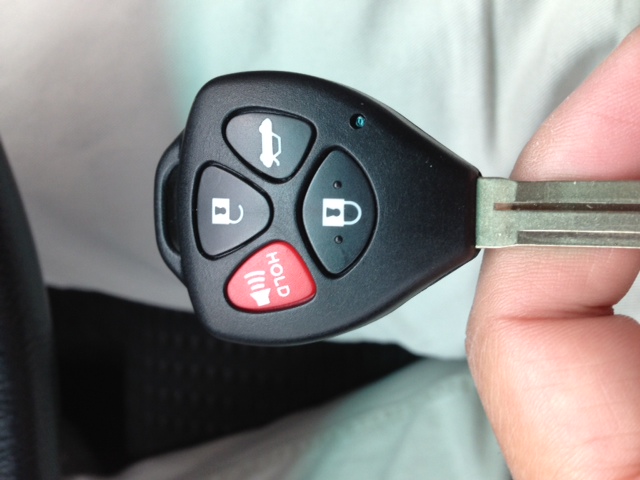

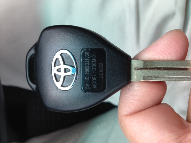

This is my exact problem as well. Can anyone provide any insight to what might be wrong? I can get to the solid light but when I insert the new key I get that 2-1 blink.
FWIW the FCCID on my OEM Transmitter is HYQ1288X. And this is the key I got off ebay in the first link of the OP:
BTW I have a 2007 4Runner Sport V6 4WD
