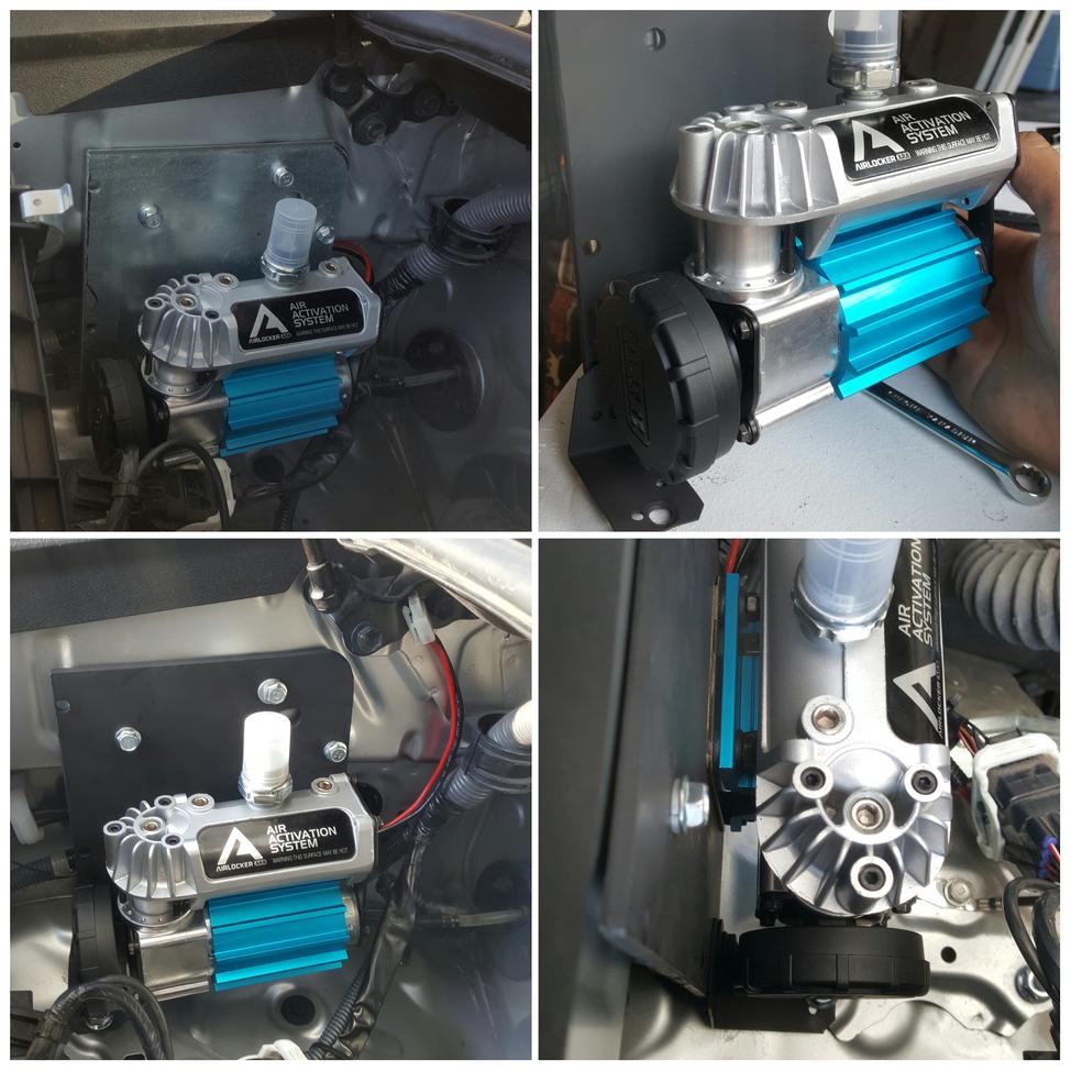

Made my own for $20 with bits and pieces from Home Depot. Holding on strong for over a year. With a little ingenuity you can make one to fit the ARB CKMA12 or twin compressor.
The pics are great. Thank you.
I was thinking of using the studs, but I like what you did.
