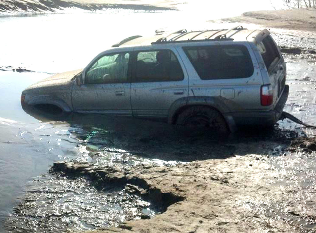

Sunk 4Runner.... The epic (picture) novel of love and loss
Flooding a vehicle is just about the worst thing you can do to one. Plan on replacing all of the driveline fluids, maybe more than once depending on how many times it takes to get all the water out of the rear axle, front diff, T-case. If it has an automatic transmission, pray the water didn't get into that.

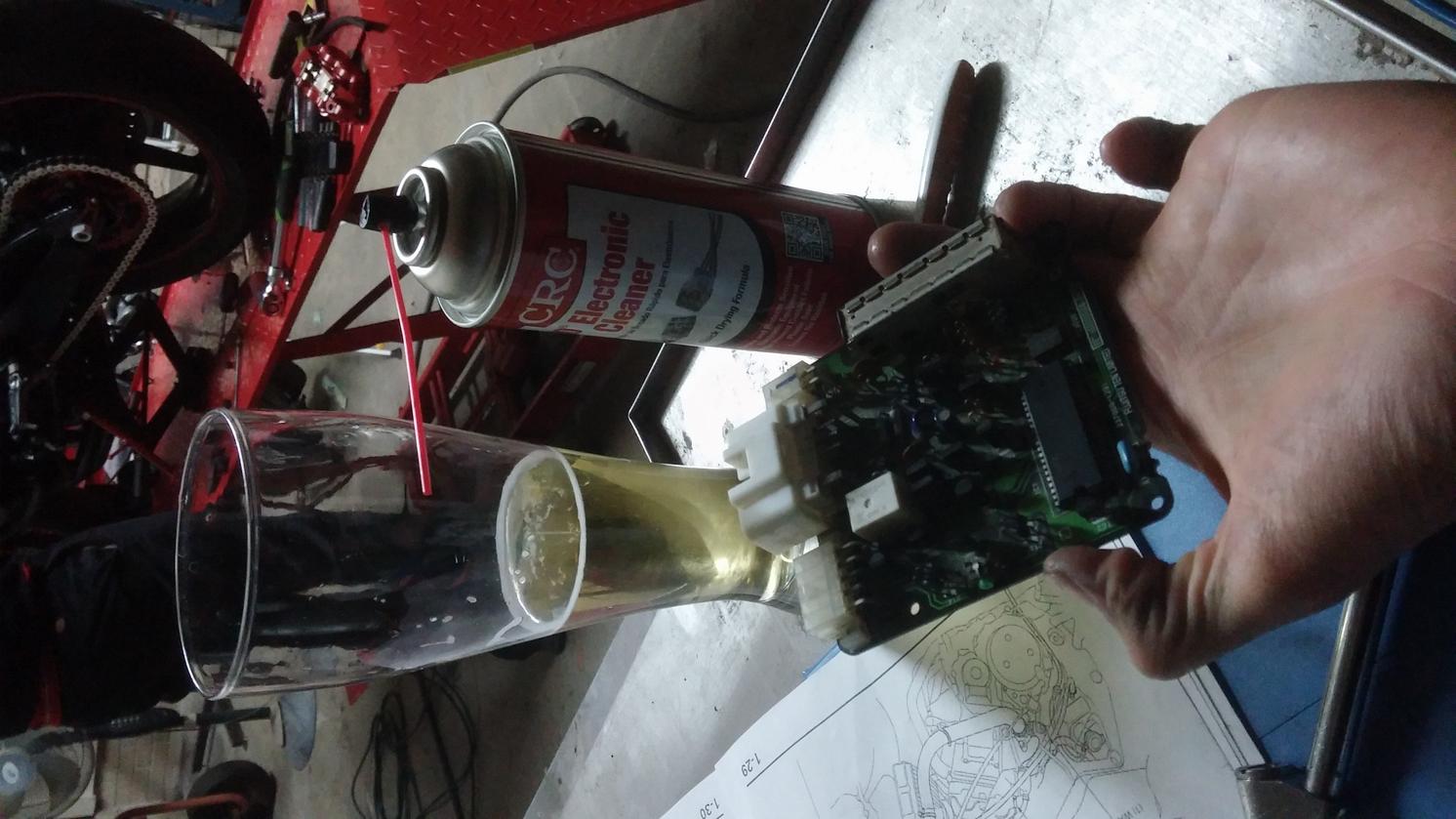

Alarm ECM should be able to be flushed out with distilled water and dried up. It might come back to life.

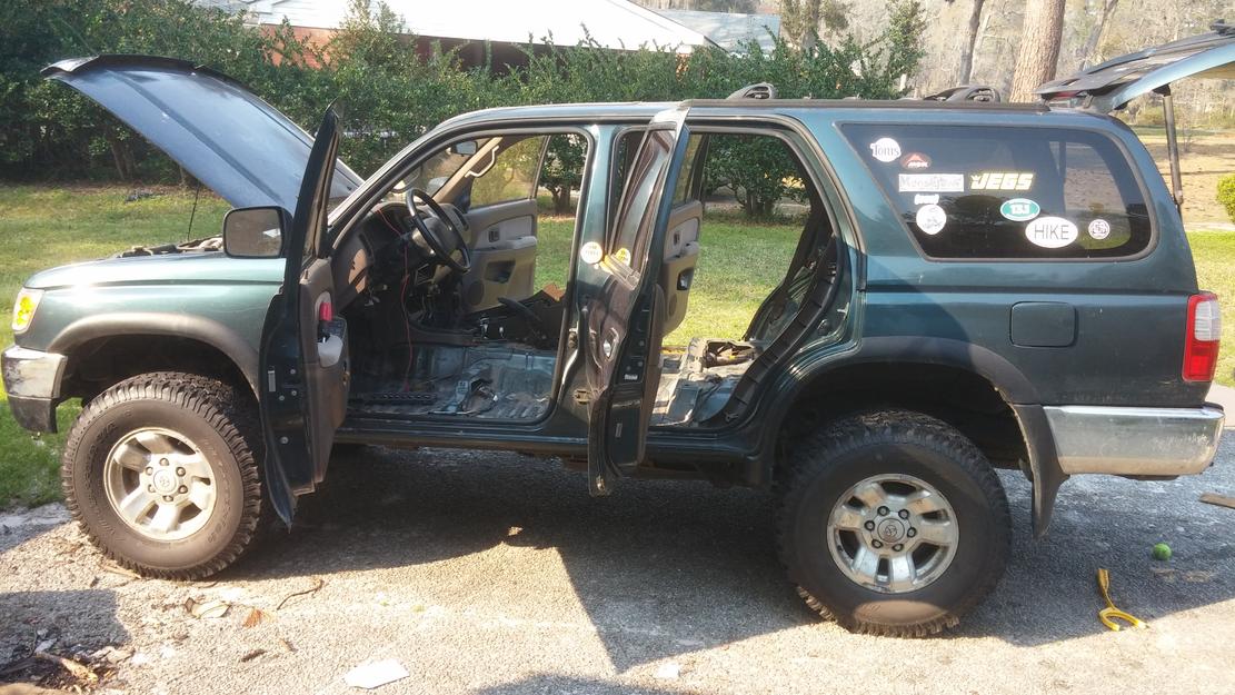

Just got the interior ripped out before my buddies conned me into playing golf...but over the night I'll be figuring stuff out!

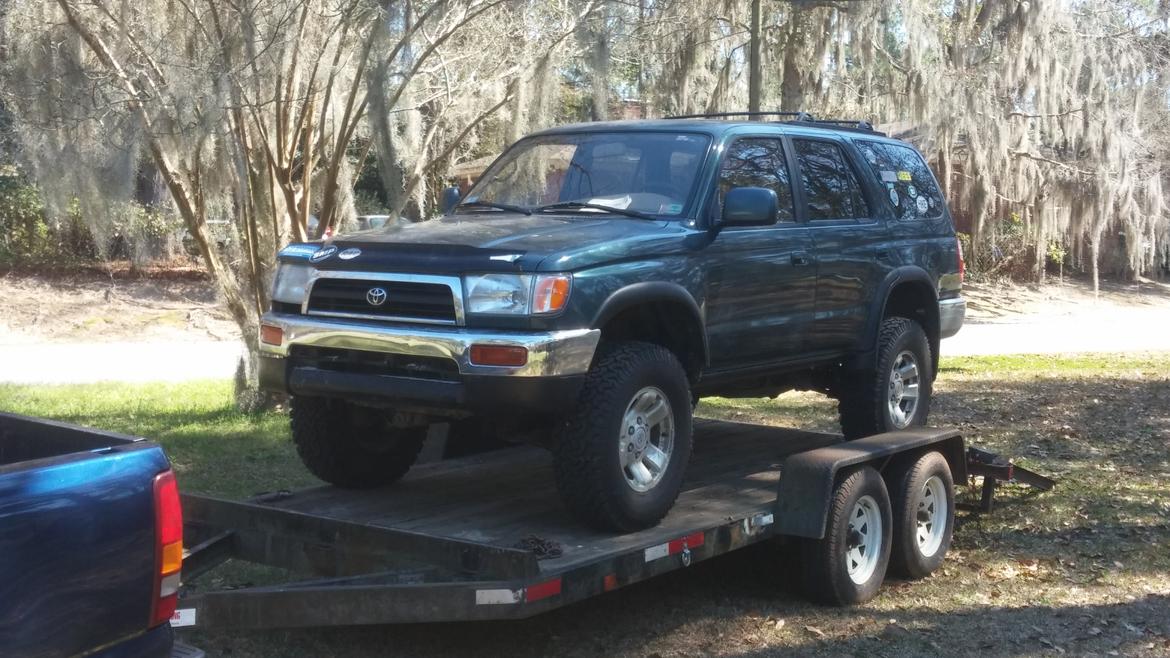

Cleaned the VIP alarm brain out (it was disgusting!) with Circuit Board cleaner and toothbrush. Looked like body ECU/fuse box was above the flood plane, all the terminals were dried and cleaned (and greased) and carpet was yanked out. Still needs to be shampooed but it will happen one night this week (or maybe just Saturday). We realized the AM1 fuse was blowing when I turned the ignition so that lead me to believe the starter was bad. (you may recall that we actually pulled the starter out and cleaned/regreased, but what you don't know is that I know nothing about how to properly test one, so we just threw it back in with hopes it would work again - no need for useful links friends, I had the diagram in my hands...but me and electrical diagrams...ugh) We roll started it and it drove around the block. Loaded her up on the rescue trailer and drove home.
Been busy with work but managed to put a few hours of wrenching in the last couple nights. Yanked off the starter again, and (with the help of my father who actually knows how to read electrical hieroglyphics) discovered that the starter was fried. Bought a new starter for 89$, threw in a new 40amp AM1 fuse and she cranked right up.

So cranked up no problem, but there is a definite stutter when there is a load on the engine (particularly in low RPM range) I am going to run a can of SeaFoam through the gas to see if that will clear this up but plan on searching a little more about the Throttle Position Sensor (I have read a couple threads where this was the solution to a very similar engine stutter ((after being submerged in water)))
Thanks everyone for your help (Especially DOC2012!!), suggestions, and humor! Hopefully all this will be sorted out soon and then I can begin to waterproof my stuff and put a proper snorkel on it (AND WINCH!)
