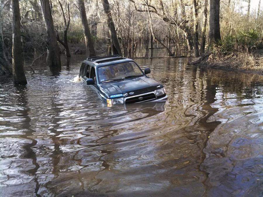

So I will try to explain everything the best I can... someone please read and enjoy my horrible weekend. But more importantly...weigh in on your opinions....please......

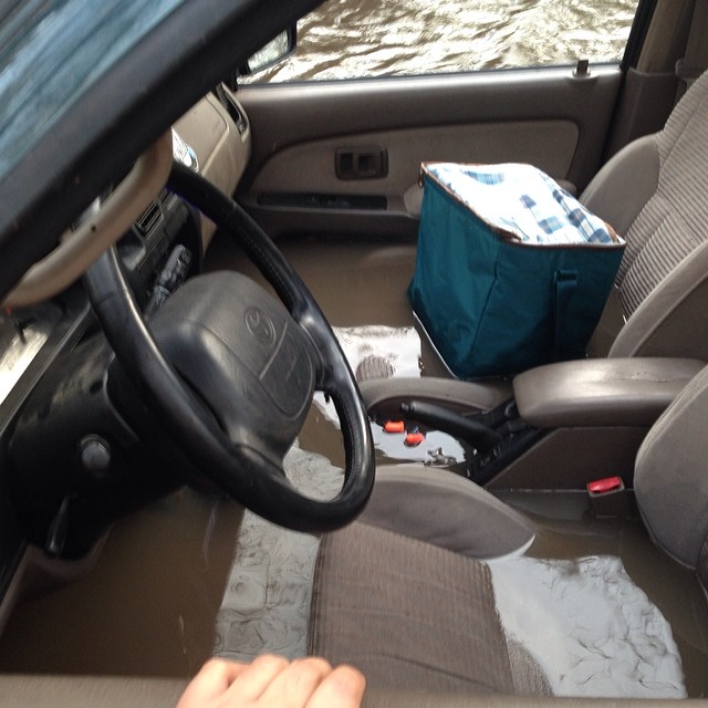

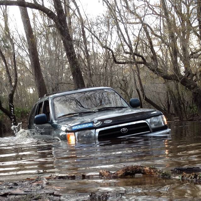

Got stuck in a river last Saturday. Water filled up the inside, not quite to the CD player, but pretty decently. The first thing that happened was the horn went off (and stayed on for the next few hours while I try to tie ropes and chains under the front end...fml) I am pretty sure the 'factory security system' got activated or shorted out...From my limited knowledge of hydrolocking I left the truck running to prevent water from going back down the exhaust. The airbox never got fully submerged so it kept running for a while...but meanwhile the lights on the interior slowly died and at some point the dash quit out. Buddies Jeep couldn't pull me out and we ended up waiting for about 4 hours (while I tried just about everything in the freezing water to free her). The 4runner was low on gas when we first got stuck and either ran out of gas or the battery died around hour 3. Hour 4, another jeep with winch shows up and pulls me to dry land. (it is dark now and I am shaking uncontrollably while trying to stay warm)

Yes, I am an idiot :amen: Knew that going in though, so what can I say. I was with some of my buddies trying to stall for a surprise bday party (bday boy included) so after shooting some clays on their hunting property we went down to the river. I drove in and turned around and came out no problem the first time, and the second time I backed up (maybe!) a foot further back and somehow when I went forward I caught the skid plate on some serious clay. With the front skid plate stuck it didn't take me 10 seconds to know I was in trouble. Thats when the horn went off and the doors slowly began to leak. :bash:
