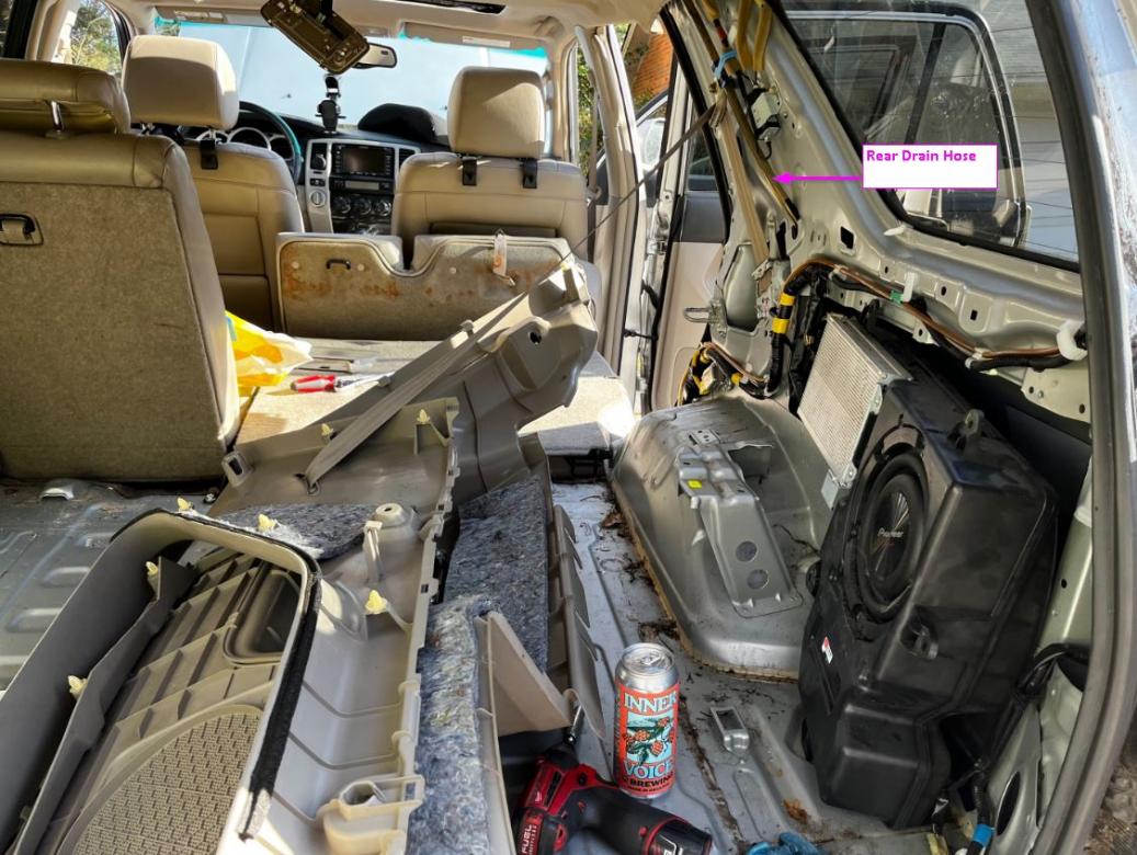

The rear corners lead into a little open-toppped box -- maybe about the size of a deck of cards. A plastic tube connects to this and goes down behind the rear doors, along the side panel, and exits behind the rear bumper cover. You can access this tube on the left through the jack storage area, or the side panel/subwoofer area on the right.
I ended up removing most of the headliner to see all this. Mine was clogged with leaves and crap. The prizewinning move was to take a shop vac and, using my hands as an adapter, connected the drain hose near the jack to the vacuum hose and sucked the blob straight through.

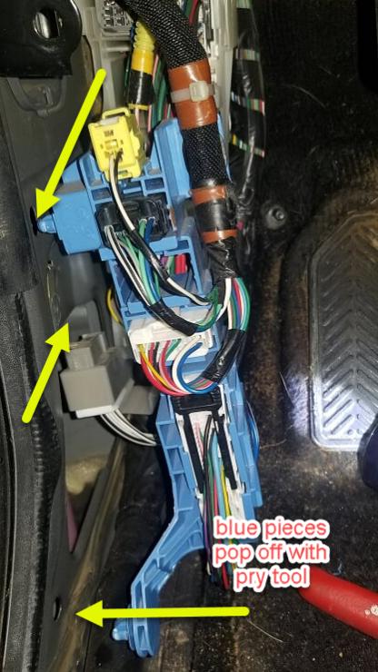

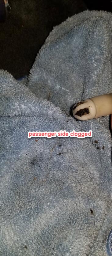

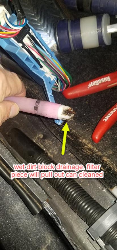

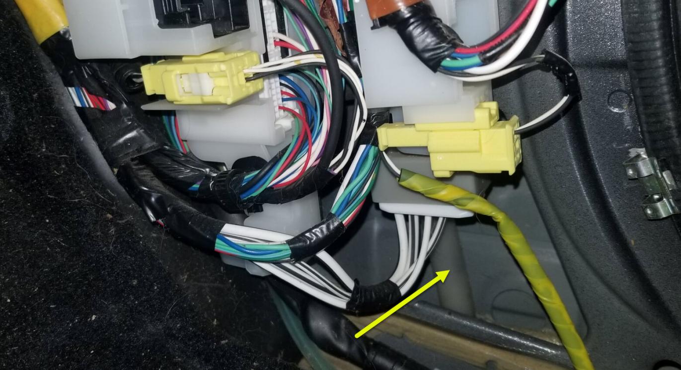

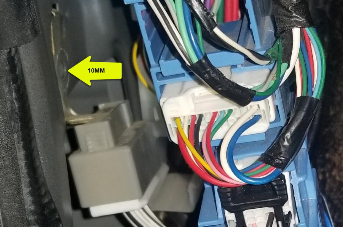

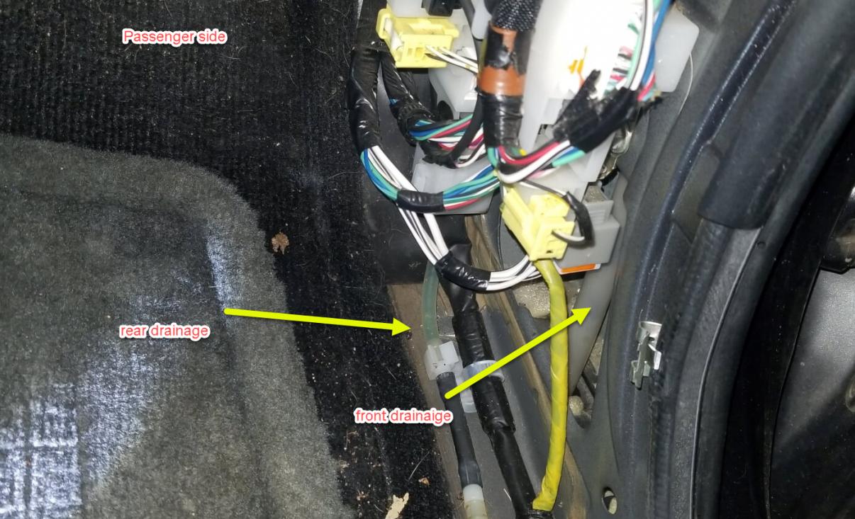

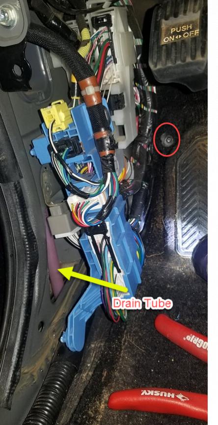

After much, much wasted time I was able to fix this today...with the help of another post on here. I took some photos to help illustrate. My issue was the water was not draining completely and splashing into the passenger area. Easy way to test is pour a few ounces of water on the passenger and driver side holes. If it does not drain right away there is likely a blockage at the FILTER.
String trimmer line will NOT solve this. You must remove the molding at the door base and to the left the emergency brake pedal. Use a plastic pry bar on the floor base plate and locate the 'bump" on your floor board that is holding the other trim piece in. Behind that you'll find some electronics. CAREFULLY pop off the blue pieces and use a 10mm socket to remove the white harness. This will allow you to remove the drain tube. Take a pair or pliers and lift up on the tube to unseat it from the hole. At the bottom of the tube check to see if the filter is clogged. Both of mine were and once I cleared them water instantly drained from the sunroof.
driver side holes.
blue pieces and
use a
At the bottom

Great pics, they helped a lot. I do have one FYI, the tubing labeled rear drain, is actually the washer line to the back window. On my 5th gen the rear sun roof drains are pink and blue and the same diameter as the fronts, but access to them is above the rear passenger doors. These lines run behind the wheel well into a grommet with a drain spout.
