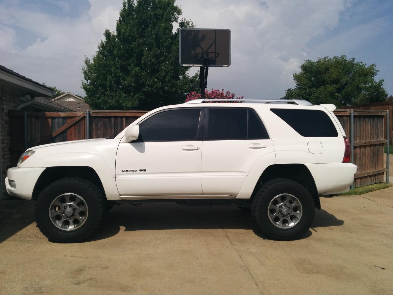

Got them installed this weekend. Rear is completely empty in this pic. Tires are 285/70/17 on 17x8 wheels just to give some perspective. The rear went up 3.75". The from went up 2". On e the rear settles a bit, I'll raise the front closer to 3" of lift.

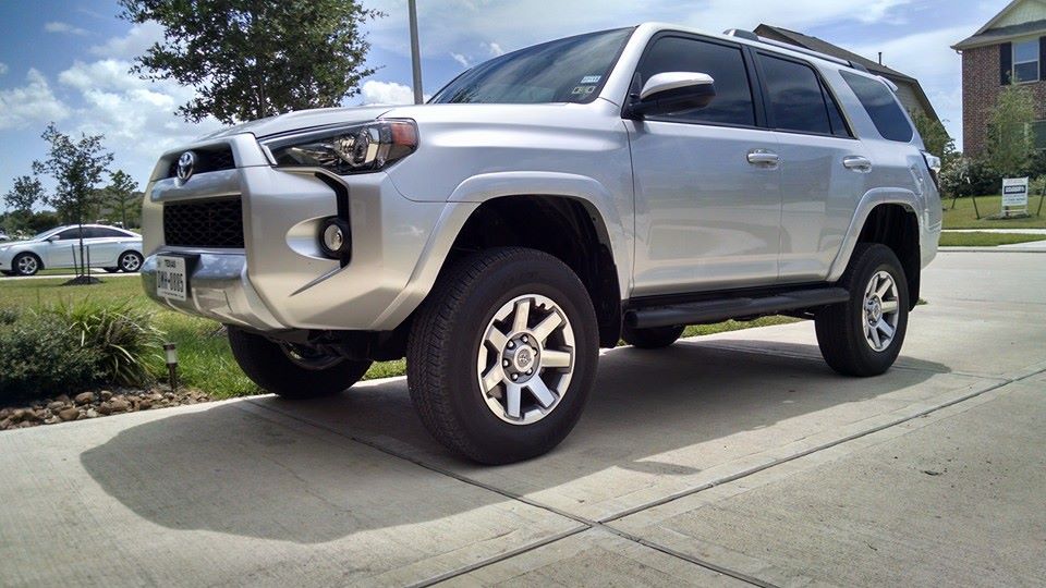

Sorry its taken so long for me to get a picture of my setup but I finally got time to. For anone who doesn't remember I have the boss kit with the 2.5" superflex HD coils in the rear. The front coilovers are left at the preset height from the box leaving me with a 3/8" rake.

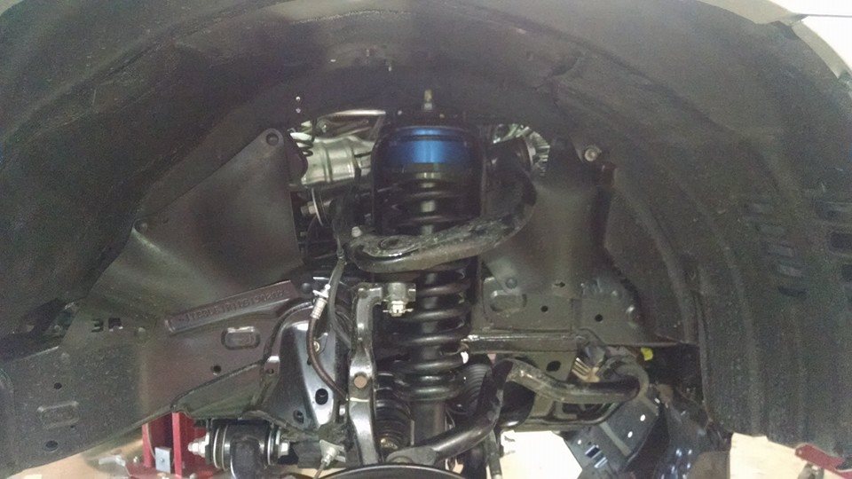

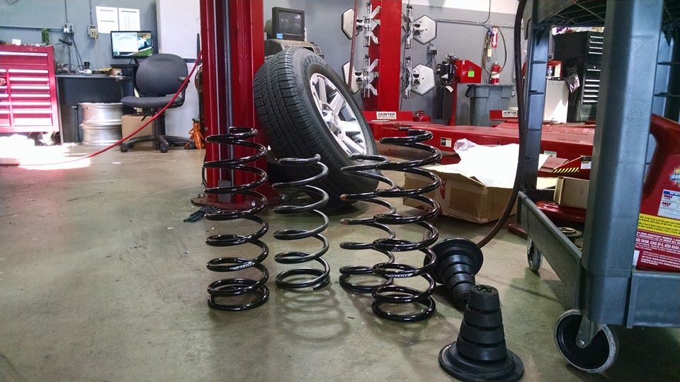

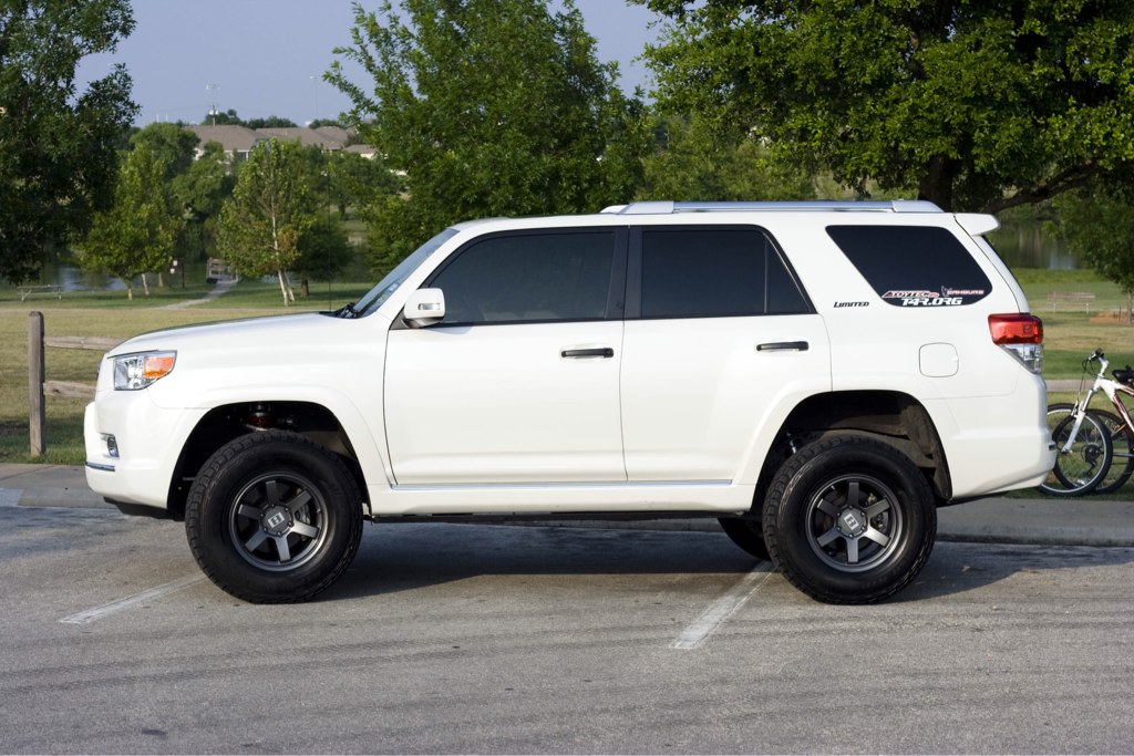

I just installed the superflex HD rear springs and theToyec 3" spacer up front on our 2014 trail last weekend as well. Here are a few pics bofore and after. Super stiff ride in the rear compared to stock. But with 4 adults it calms down alot. And i know ....needs more tire haha ! Working on that and some spacers in the near future!
