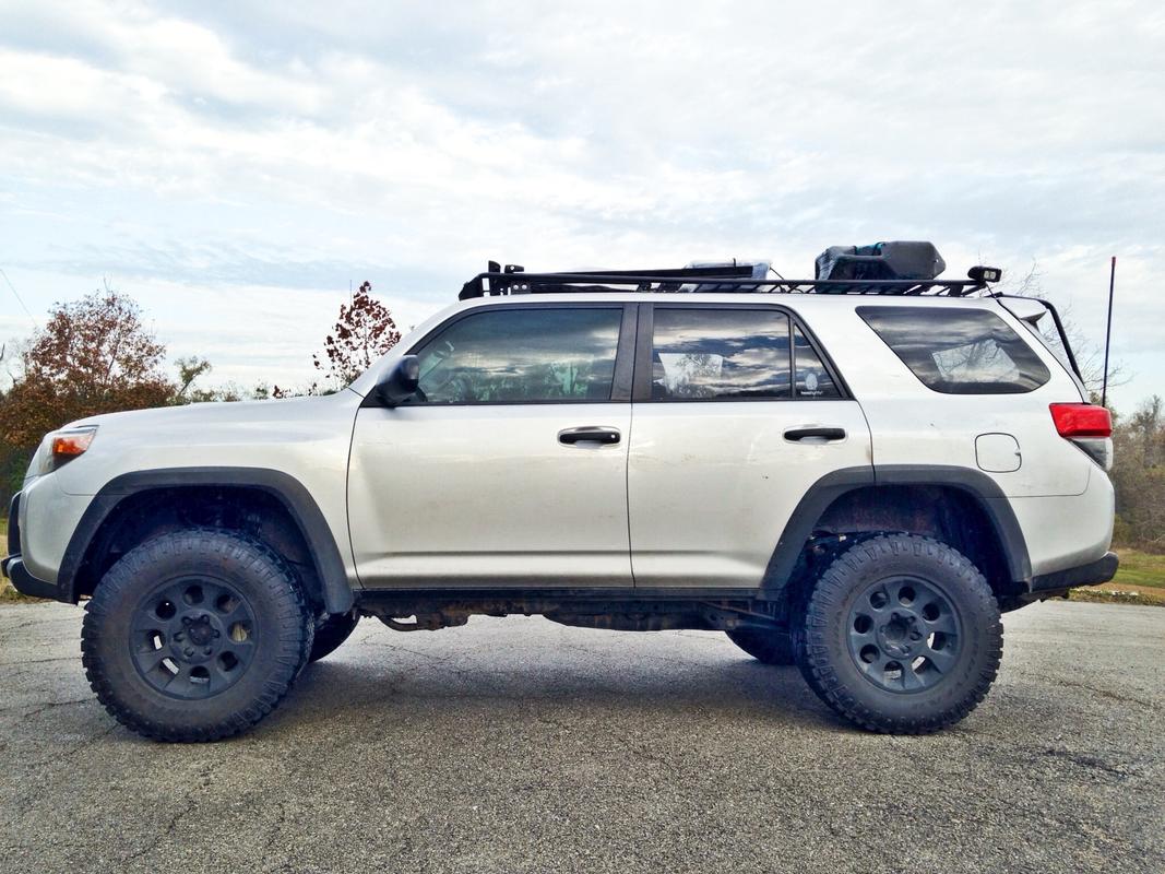

I wouldn't add the 1 inch spacer it would be a mistake. I have the OME lift with the 6mm/1/4 inch spacer. It lifts the truck between 1/4-1/2 and inch above the 2.5 inch lift. My CV angles are fine and it handles the way I want it to. Here's what I posted in another topic:
So last week I bumped into a guy who was running the exact same setup as I have ome884 up front but also had a 6mm spacer on top giving him about 1/4-1/2 inch of lift on top of his 2-1/2 inch lift. I've always wondered if this was ok to run this setup with stock uca which he had. He had 53,000 miles with no problems at all. After a lot of phone calls/emails. I talked to a couple Toyota techs, one of them a relative and the and the consensus was that the 4runner stock is an extremely capable vehicle but most people throw a lift and replace stock components with "race" components when they never really pushed the vehicle in the first place. I never really wanted to deviate from the stock components just to minimize maintenance and possible failure. The guys over at Equipt have been running a 3 inch OME setup for a while now and they've been over landing for LONG time so I trust their judgement. I think a lot of it has to do with what type of driving you typically do. Most of my off-road driving consists of barreling down dirt roads / beaches and crossing washed out sections which I do 3 days a week.
Here's how the truck looks:
Nice!
Sounds like the 1/4" spacer is the way to go!
