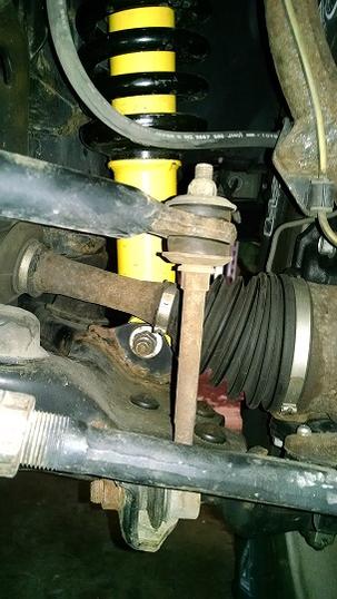

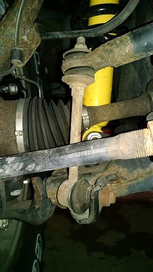

I've got a front end "clunk" going over small road deviations, speed bumps, driveways, etc. I just replaced the front struts, LBJs, and Sway Bar End Link Bushings. Trying to look for things that could be causing the noise and just noticed that the driver side Sway Bar End Link looks a little off. It appears to be rotated toward the front of the vehicle. Does this look normal or is this likely what is causing my noise?
Driver Side:
Passenger Side (For Reference):
What else should I look for? Inner/Outer Tie Rods look to be in good shape.

Those end links don't look to awful bad snapped off or anything does it occur when turning the wheels at all... Also did u replace struts recently and forget to place the rubber strut mount top back in place

So that bottom end doesn't look odd even though it is turned forward?

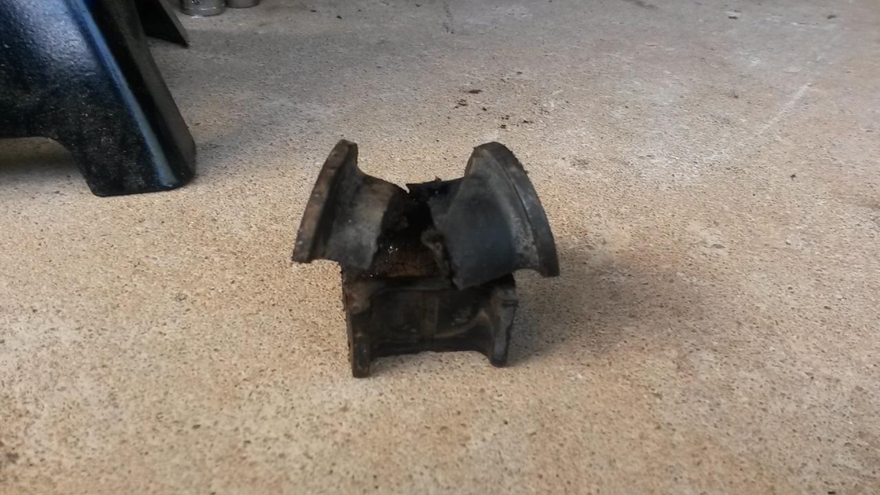

How do the bushings look where the sway bar mounts under the vehicle? I had a clunk and my end links looked good but the others under the vehicle were toast.

If the swaybar endlink is rotated towards the front and is close to touching, its almost 100% sure that that is your clunk. The passenger side on my truck failed after 6 months.
