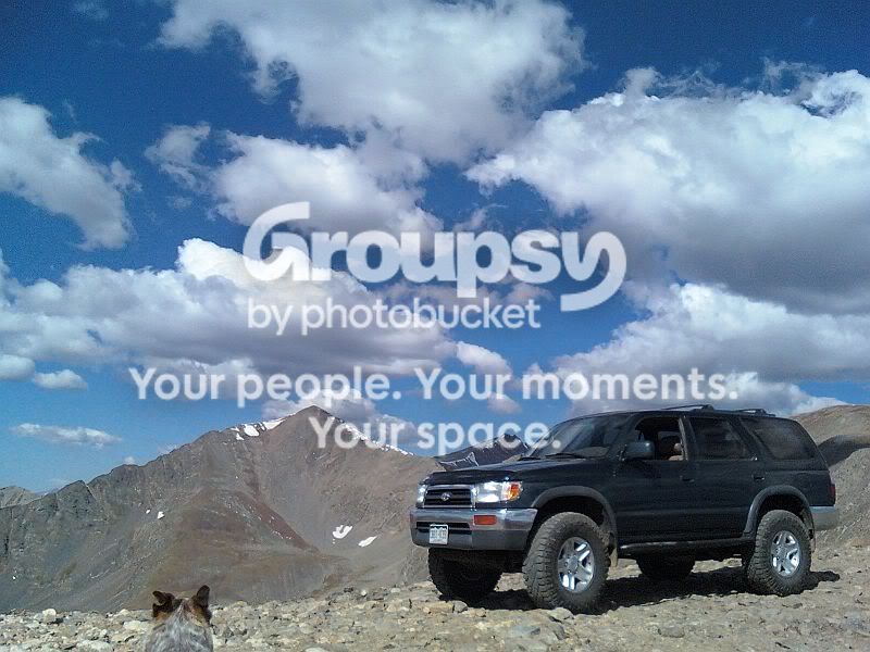

No sag unless loaded with family, coolers, and camping gear in the roof box. Then it looks like this (still equipped with stock struts AFAIK)
IMG_5887_1024.jpg~original
Without people/dogs/gear:
0927011103a_800.jpg~original
