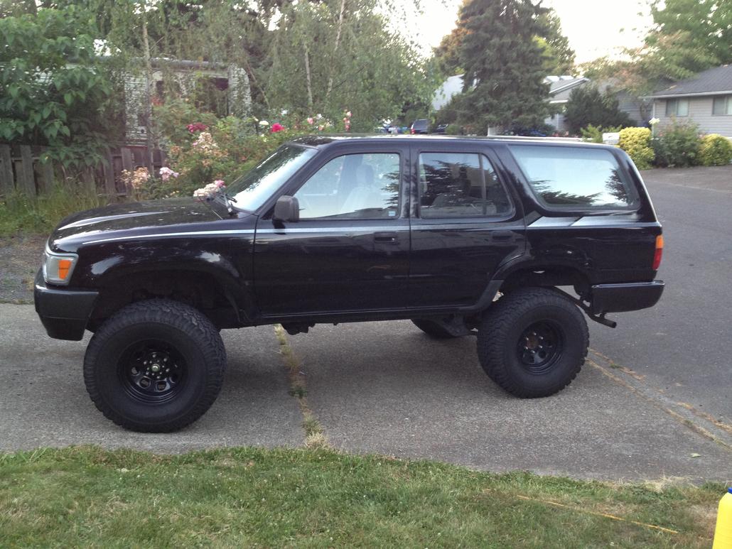

I have a 3 inch OME , a 1 inch body. Panhard drop kit, diff drop etc. It preforms to my requirements. As you can see it doesnt get thrashed. I dont rock crawl, I go exploring and go as far as I can with what I have. If you want to be able to tow I wouldnt go as high IMO, but thats just me. I have a 22RE Ill never be able to tow with those tires. Unless I want to go 20 MPH the whole way.
