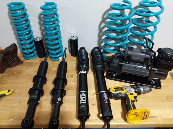

I just had these show up (Dobinsons IMS) and the fronts are fully height adjustable. I bought this setup for the exact same reason - going 2.5" right now but will be adding a winch, bumper, etc. and will be able to raise the spring perch and not purchase new parts - just a new alignment.

I've very satisfied with them for the price point - hoping to get them on this weekend, or else next weekend and start a long term review of them. The quality is great and I like that they don't have a stubby shaft holding the bottom mount (I know likely not an issue ever, but why skimp).
I like to read other people's opinions on products before buying, found a little on these from guys in Australia (been on the market a few years) but that's about it.

At this time I didn't buy the UCA's, which is a part of where I'm not going over 2.5" without all the front end parts on. I was on the fence with going IMS over the basic Dobinsons set, but ordered when they had the promo throwing in a solid air compressor (about the same specs as the ARB dual for CFM) which swayed me into what looks to be a better product.
I got the coilovers assembled and ready to go last night - hopefully I can get to the actual install this weekend - I'll keep you posted!
