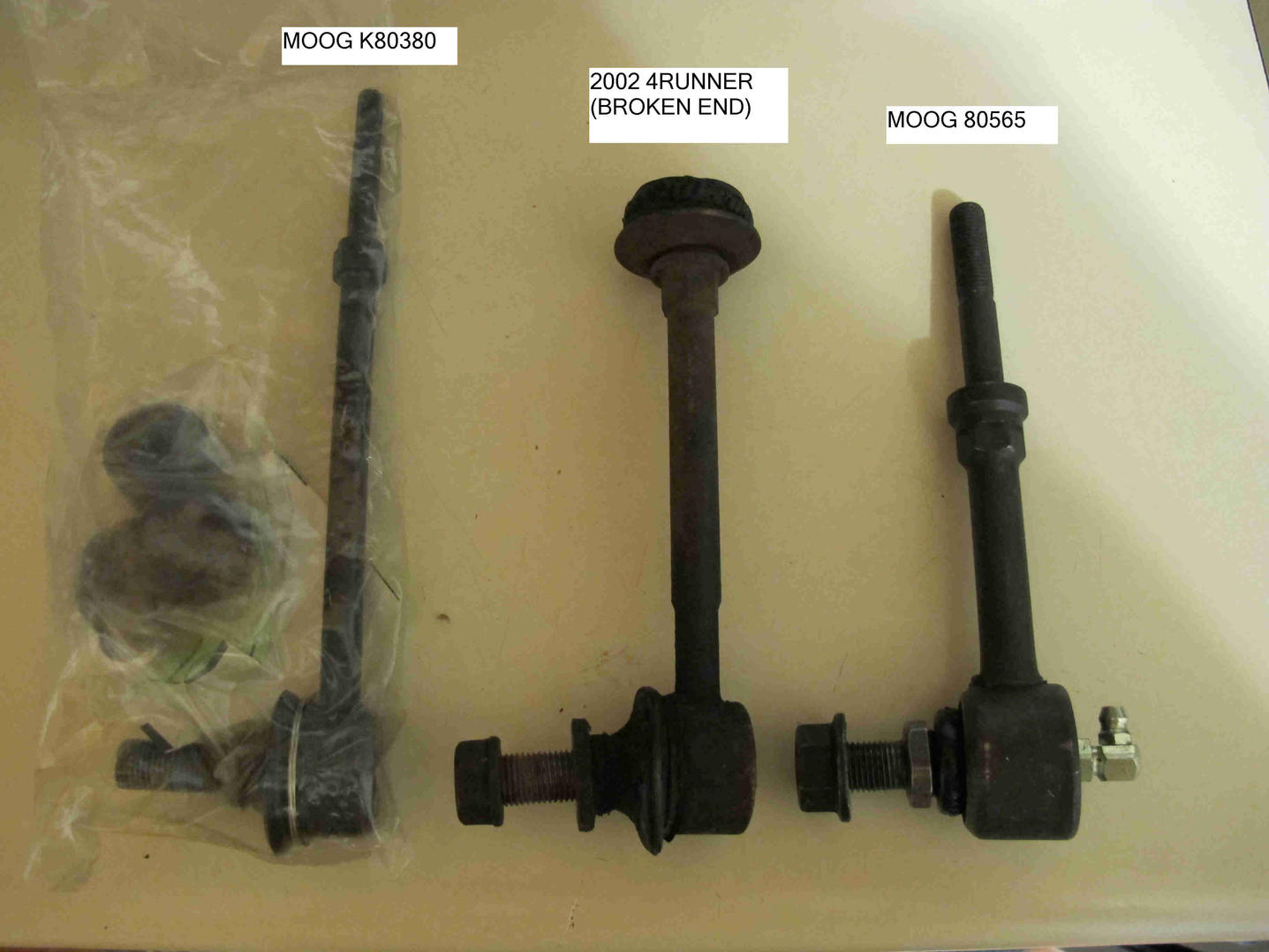

I received my order from Rock Auto. Unfortunately I was not advised that they are sold individually so now I have only one of each. Also one of them arrived opened with no hardware. After reading what was posted here I thought I'd provide some evidence.
At the right is Moog K80565 "1995 4runner front." Note that it has a zerk at and also does not narrow at the bottom like what I pulled off the truck (middle). K80565 is 1-1/2in shorter than 2002 stock.
At the left is Moog K80380 "1995 rear". Note that it is thinner throughout (3/8in vs 1/2in for 2002 stock). It is 3/4in longer.
Since I have only one of each I'll have to hit Pep and Advanced to see what they have. Worse case I just do the steering rack this weekend and the sway bar later. I don't really need the disconnects but I may wind up having to buy the ones mentioned in previous posts on this topic.

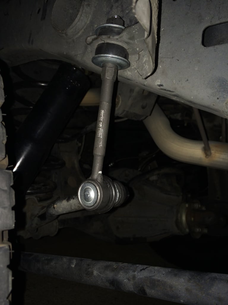

So I JUST did my rear sway links to correct the steep angle I had after swapping to the 8 wraps. I was going to go with O.E. 3rd gen fronts but said FACK that after I priced them at one and a half bills. I ended up going with AutoZone brand(Duralast) end links. From what I was told, they are manufactured by the same company that makes Mogg links as well. They were double the girth of my O.E. ones. I used 3rd gen fronts for the rear. They are EXACTLY the correct length to bring the sway back to correct geometry. Bolted up nicely and are beefy and well made. Came with all the new bushings and hardware as well. I'd suggest going with AZ FTW. Unfortunately I didn't take any pics of the comparison, but if anyone is seriously curious I can hold my O.E. one up to snap a pic for comparison. The model number I used is SL3560 or DSL3560. Here is a direct link to exactly what I used.

And here's a picture of my passenger one installed.

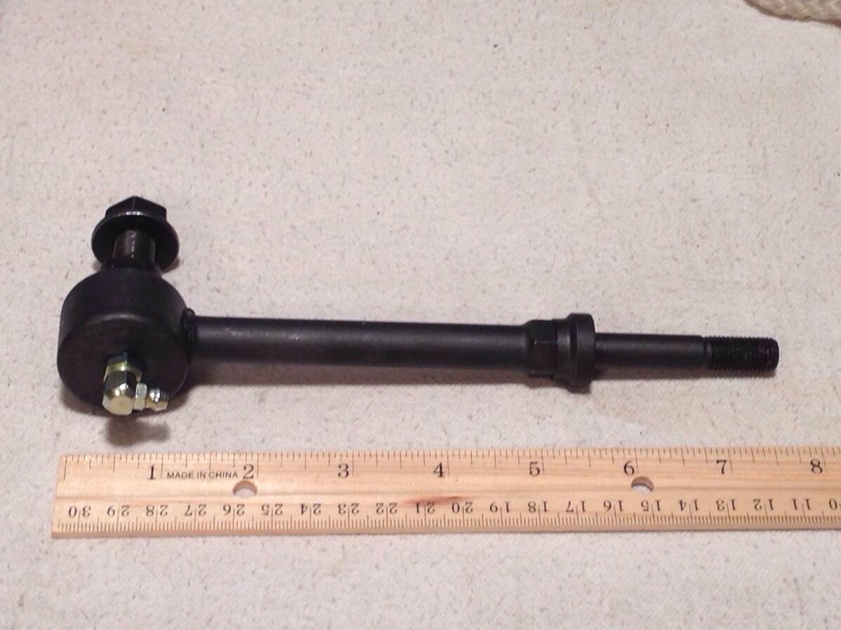

Here is the Moog K90681 I will be replacing the OE rear with. Feels pretty solid and looks like it should be the right length.

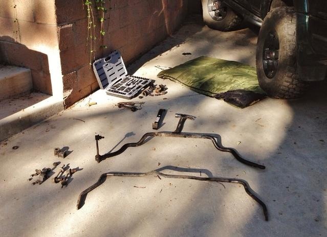

FWIW - I was all ready to replace the rear sway bar links and bushings, but took it for a spin down my local test trail after removing it and really liked the way it felt without it so decided to take the front off as well.
Could definitely feel the rig conforming to the trail much better in the real undulated sections and definitely mellowed out the harshness of the OME's. I really like it so far and plan on keeping it sway-free for now.
