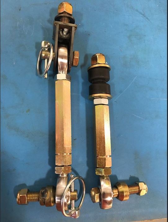

New 3rd disco's are available! Pricing is up in the first post.
Mike, I have your older 3rd gen double-disco. Can you explain why you made the change? it does look like it will be much easier to line it up to reconnect compared to having the bushings at the top. Getting that pin to line up can be a real bear.
You just answered why I made the switch.
It's a better design, and makes everything easier to use. This design allows for a larger diameter pin that won't bend. This is also a bit quieter design.

Pictures are from an FJ Cruiser, but the 4runner's are the exact same. He does have a relocation kit installed on this FJ.
quick heads up, that isnt the same as a 3rd gen 4runner. the pickup points are different.
