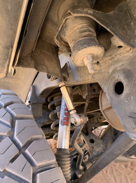

Glad to see this thread is up and running again. Always wanted a pair of these and I finally got the opportunity to purchase a pair for the rear of my 4th gen. Definitely made a difference in feel and articulation. If I remember right I set them to almost 1.5" longer than stock to get the bar parallel and to have ample clearance down below.
Thanks [MENTION=98153]MStudt[/MENTION] :guitar3:

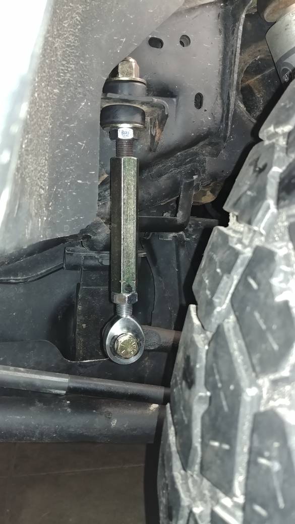

Also, Mike, when you see my pics, lmk what you think of my locknuts. I didn't snug the bottome one up against the couplers yet. In this way I could even turn them by hand to mess with the amount of tension I wanted on them. Now that I have them where I want them I may snug the locknuts up but lmk your thoughts.

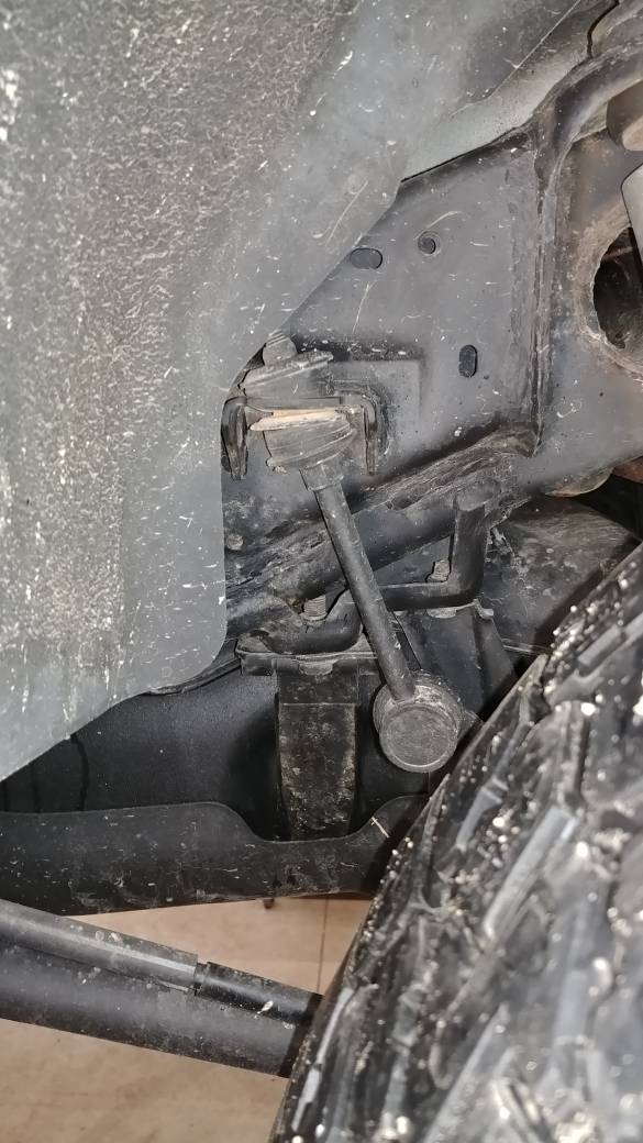

Question. Have you guys noticed on the front that the larger diameter links contact the spindle just prior to full left or right steering wheel lock before the steering stops make contact?
Just installed the 5th Gen front and back links. Quality was good and Mike was very responsive via DM.
I've heard this happens in 3rd Gen Tacoma's, but this is the first for a 4runner. I can send you new upper boots with a spacer that'll fix the issue.
Mike
