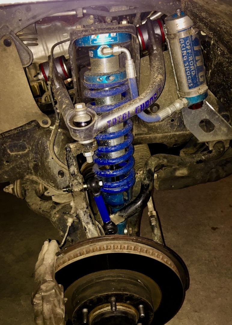

Installed front and rear a couple weeks ago. Mike powdercoated these for me. Great product and can really feel the difference. will post a photo of the rear links soon
