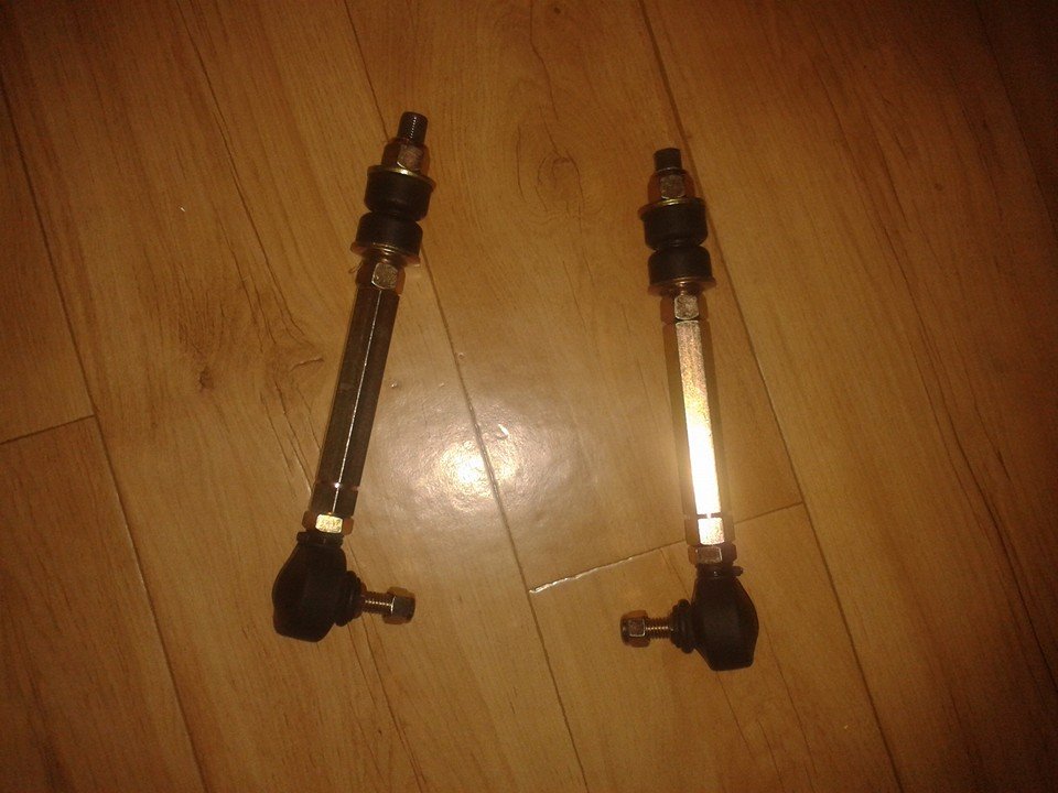

Got my links in... and installed! Thanks man! :)
