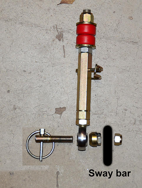

Hi, I got my sway bar links from you today. Awesome :)
I am a little confused on one point though. How the rear lower part of the link attaches to the sway bar.
I attached a of photo of a possible method but there is not enough threads to make this work.
Is the stud supposed to stay attached when disconnected? Or does it also come off after you remove the clip?
Anyway any help on this point would be awesome :D
That's how it should be. How much are you short by? I haven't had this happen before, and I did nothing different when making them.
