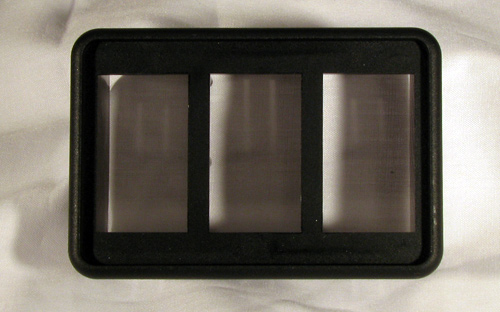

The OTRATTW switches do not fit the OEM locations. They are taller and wider. Instead of trying to dremmel out the OEM location you would be better off using one of their holding panels. That way you can pop them out easily etc if needed as well. For minimal cutting, check into mounting your switches in the little cubby hole at the bottom of the center stack.

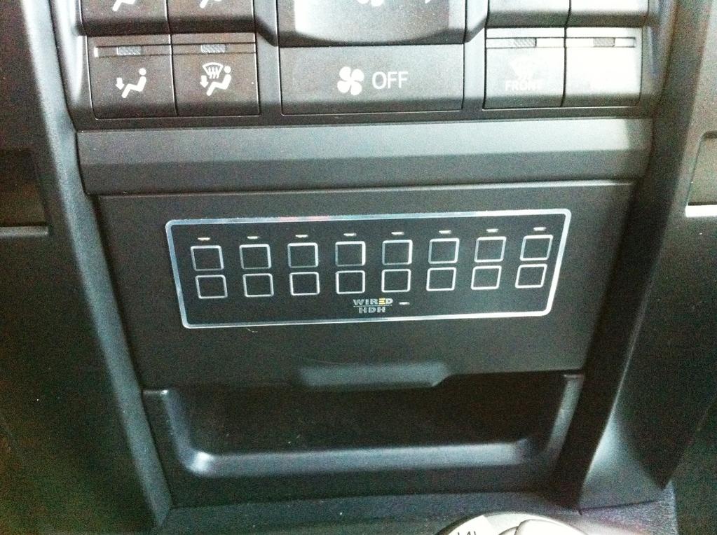

For the price of that switch panel, look into HDH wired switch panel. Ducmonsta rocks that one on the center stack lid and it's pretty damn awesome. Gives you 24 programmable switches. http://www.wiredhdh.com/#!__switchpanels

For the price of that switch panel, look into HDH wired switch panel. Ducmonsta rocks that one on the center stack lid and it's pretty damn awesome. Gives you 24 programmable switches. WIRED HDH, HEAVY DUTY AUTOMOTIVE PRODUCTS, COLORADO

uhh, for someone who only needs one accessory switch (like me), it would be extremely arguable whether it is better to dremel out one stock switch holder, or to cut out a hole in your dash big enough to fit one of their 3-switch holders, and then blank the two unused holes.
the finished switch hole that I now use not only securely holds the OTRATTW switch, but said switch can be easily removed should I ever decide to do so.

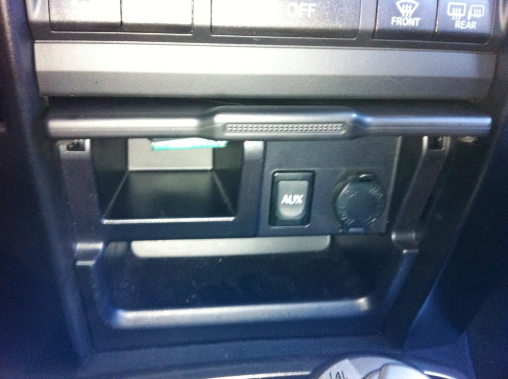

The other thing about Kodiak's switch is that it's 1/2" thick. You can't mount it the way I wanted to. I did it on the flip up cubby hole in our center console.
And you can still flip the lid up.
Sorry for the crap cell phone photos.

I just scored a pretty good deal on a wired HDH switch panel from the FJ forums. It was an open box but never installed, so virtually brand new. He had 2 and I purchased one from him, so there's still one more available if anyone is interested.
