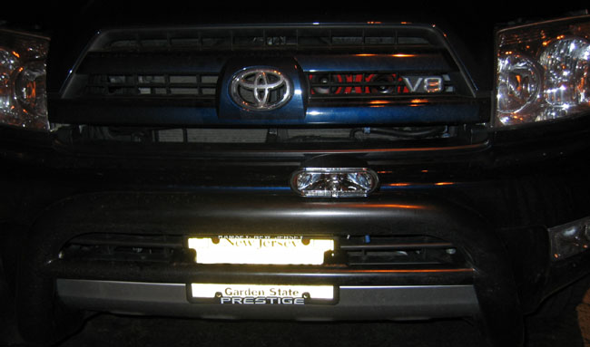

So I tried to fit/install the lights tonight but there's some bad news. The lights don't fit. I sat there for about 20 mins just looking at it to see how else I could mount them. I took some pics of where I thought might be good.
Here's option 1:

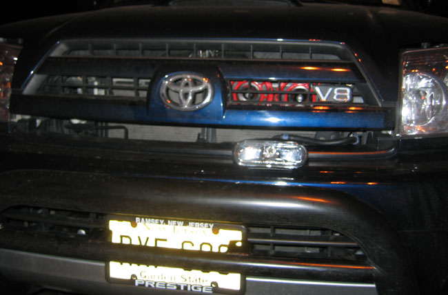

And Option 2:

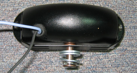

I like this option better than the first since I don't have to drill into the bumper. Instead, I'll be drilling into the bull bar which leads to a question. Would 2 holes on top compromise the integrity of the bar or am I just being too anal? I think it would be fine unless someone has a good arguement against it. I noticed that the newer T&H bull bars have the tabs on top now. Bastages.

i think you'd have to worry about oxidation, especially since you have the powder coated bar with only a 2-year warranty. May i ask why they don't fit? it looks like they should.
also, with the first option, you don't have to drill into the bumper. you can make a bracket to try and mount them from the front grill.

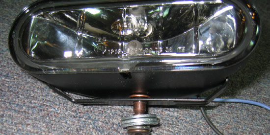

I would use some silacone sealer to prevent corrosion. They're too tall with the bracket. I thought about modifying the bracket but the bolt that holds it to the mount sticks up too much. Well, it would work but the lights would point about 10' in front of the car.
I was looking at it to see if I could make a bracket or something to hold the lights and I can't figure a way that would work and not vibrate and move. I played with the idea of welding the bracket on so the bolt won't interfere. They won't mount from the bottom either.
My concern with drilling into the bar would be moisture getting inside the bar. The silicone should take care of that, but I think I'd worry about it.
Does the bracket have a slot that adjusts the height and it is still too tall?
How much clearance are you short? Maybe you could buy a flatter head bolt? Sites like McMaster and another one that had something to do with small parts should have something really flat.
Good Luck. Oh, btw, I think Option 1 (mounting to the bumper) reminds me of the lights I see on tons of Jeep Grand Cheorkees.....which isn't necessarily a good thing. If you are mounting on top I think you might as well have a larger light.
Have you tried mounting them, using the existing mounting locations, so the hang below the bar? Sorry to keep rambling on with question after question.
There's a hole at the bottom already so moisture isn't much of a problem. The bracket doesn't adjust height but I could go at it with a dremel but there's still not enough space. It's about 1/8th" too short. The flatter bolt probably won't help much.
If I were going to mount on top I should just go with a 6" light. I thought of that already.
Can't do it below the bar because the tabs have sides for support.
I'm not done yet. I'll figure it out somehow.

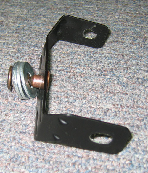

Now I drilled and grinded the side holes to slide the mount all the way down so there's a minimum of lift from the bracket.
I haven't mounted them yet and since it'll be raining tomorrow, I'll probably wait a couple of days to install them but I think this will work.
Hella measures just the light housing dimensions not including the brackets. PIAA measures overall dimensions including the brackets so I think the 2100XTs might fit better but they're also much more expensive. If the Hellas don't fit, I'm going to order some PIAAs.
Stay tuned...
