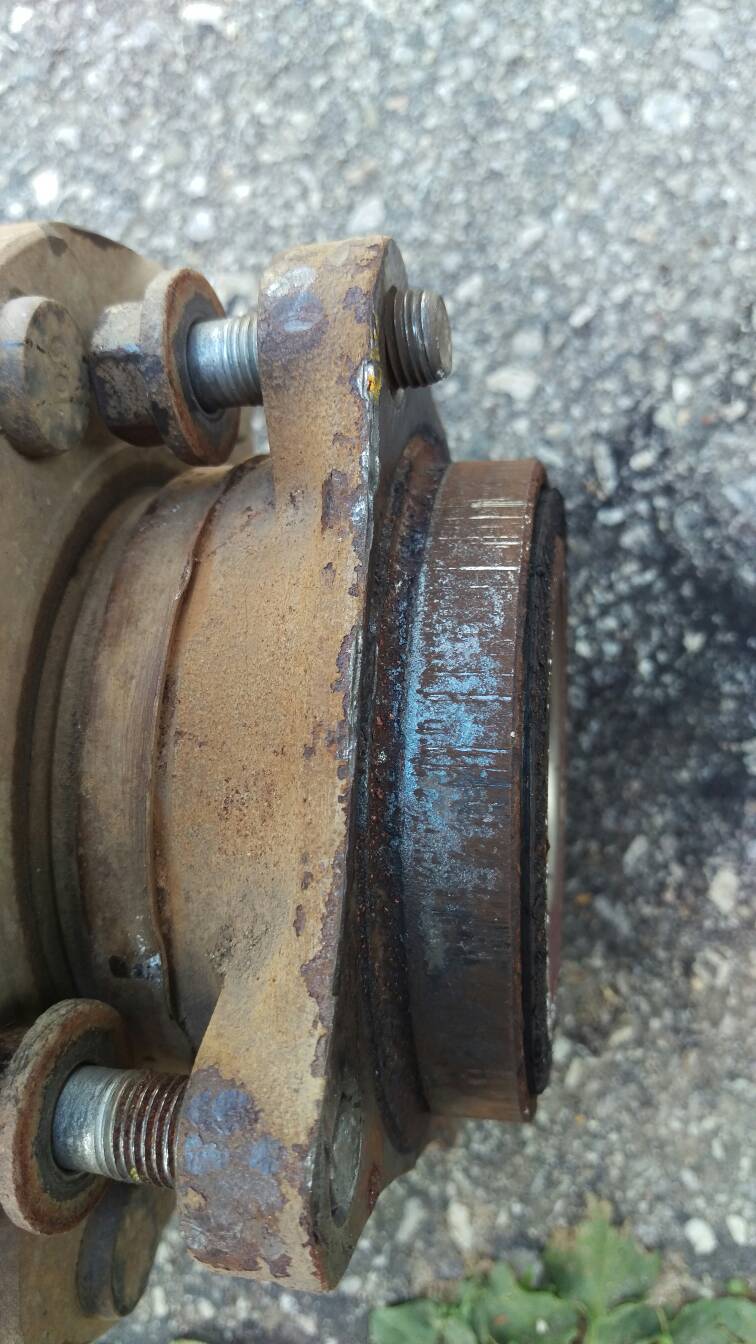

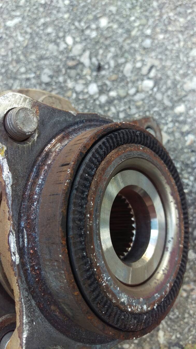

No sounds until they are completely trash, but then grinding on corners and such. Last ones were spitting out bearings and just a pile of metal shavings and dry. This one I just pulled out is in tact but barely. Lots of metal shavings! It's very loose. Mounting surfaces and seals look good.

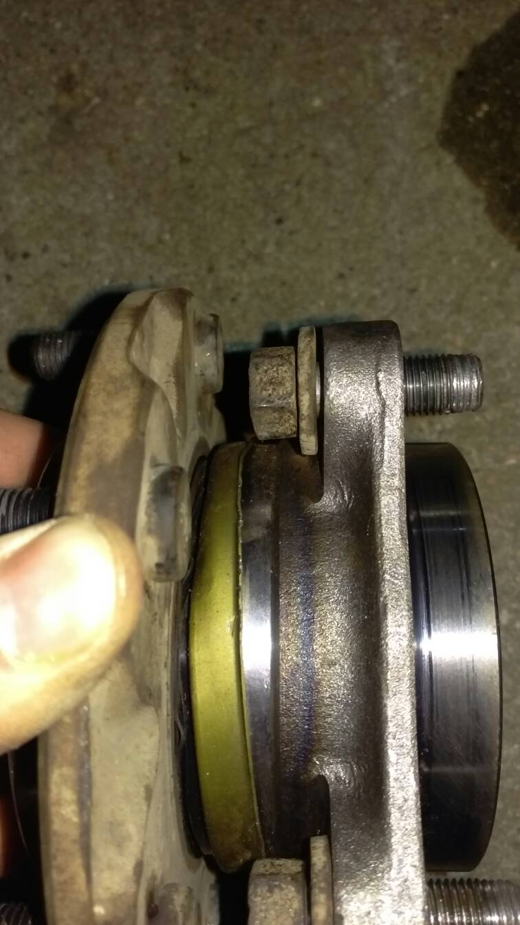

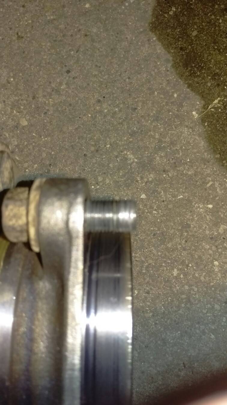

Well the mechanic messed up yesterday and I had to get a whole new bearing, wheel seal and bolts today.... Want happy. He squished the bolts, ruined the seal, then the bearing trying to take it back apart.
WTF?? So did he call you and be like "Uhh... I messed up."?
