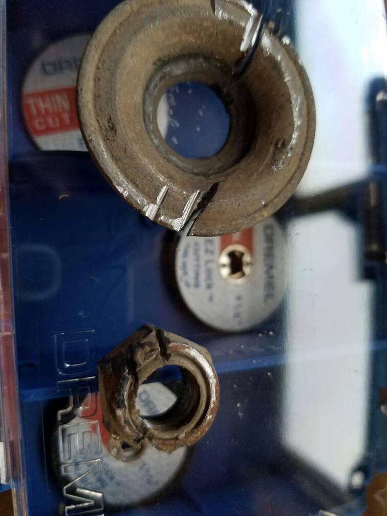

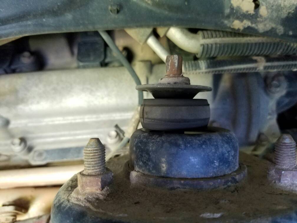

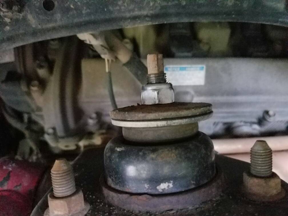

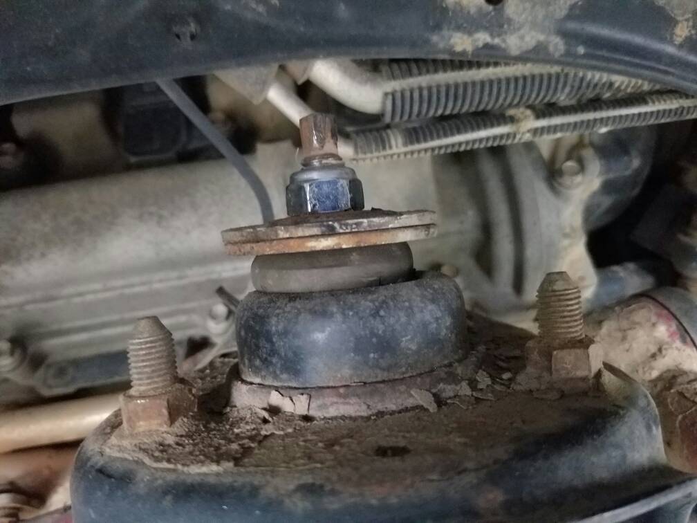

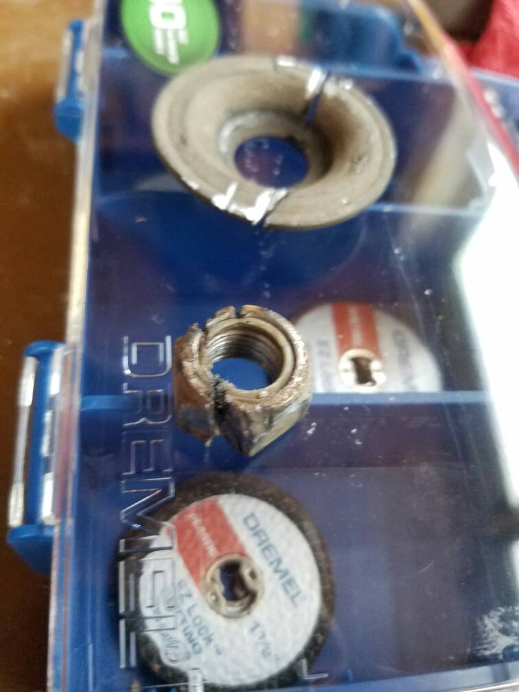

Fixed my stripped nut and messed up washer on my front shocks. Cut it with a dremel then spread it out with chisel and popped it off. Replaced with new lock nuts. Used my old uca washers double stacked to take up the space and make sure it never bends like that again.

I think the washer with the slices is the one that goes on top of the lower bushing before the tophat. The top and bottom washer are flat.
It used to be flat. It's the one that goes there it just got destroyed and cupped up, then the cut marks are from me getting the nut out. The one that goes on top has a slightly concave shape to hug around the bushing, as you can see mine no longer did. Lmao.

Your front shock washer issue is concerning to me. Two things kill shocks - over-extension and bottoming out. In this case, you maybe overextending and the internal shock bumpstop is doing its job but it's not meant as a long term solution. Just my .02 cents worth!

That's quite possible. I do have the TRD coils on the top perch. As soon as I can get the rest of the funds together I'm going to be revamping the suspension and hopefully minimize the issue's. For now, as long as I don't blow these shocks as well, the replacement washers are more than strong enough. Lol.
