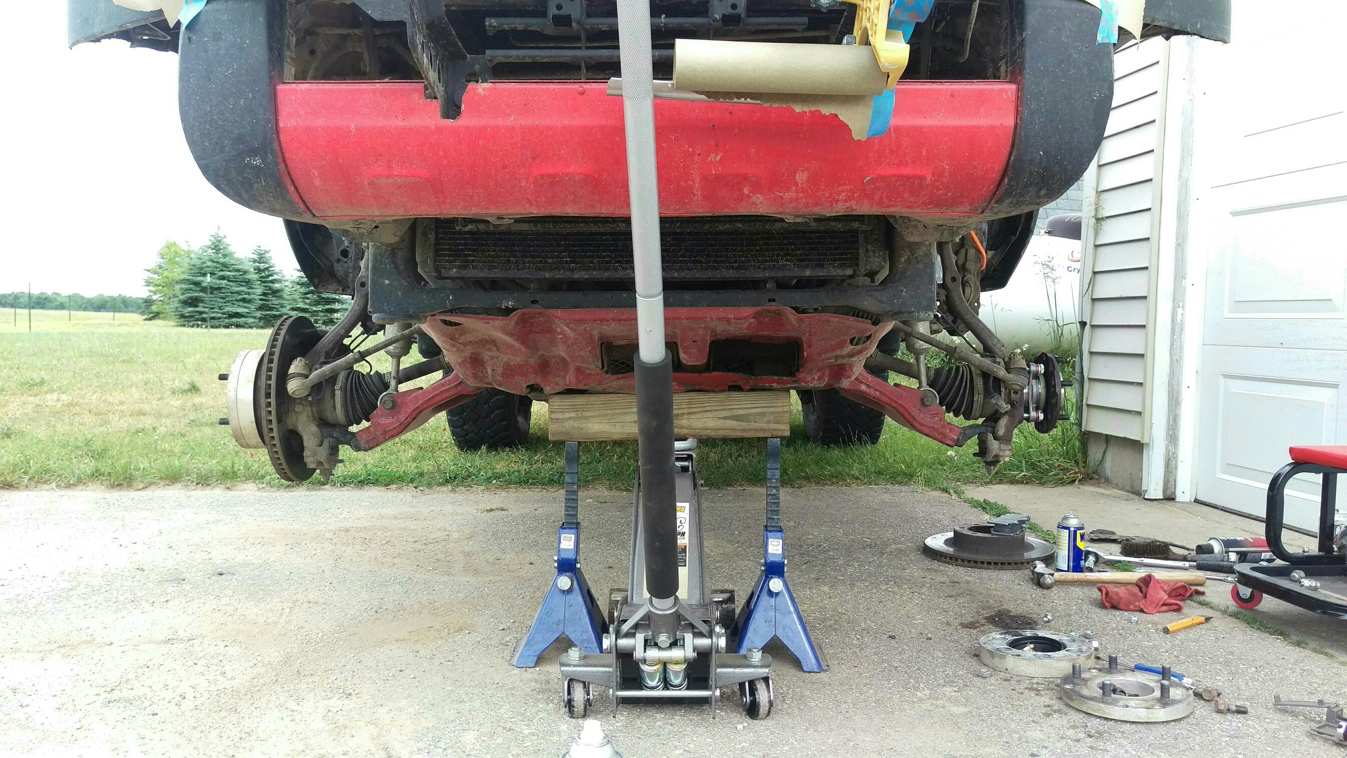

On a side note, anyone know why my passenger side suspension hangs down 1.5" further than the drivers side?? Literally.
Nevermind, now I notice. Could it be because you're missing the weight of the rotors and stuff? What UCAs do you have?

I don't notice it... I'm guessing you measured?
I tried pushing down on it by standing on it and it doesn't go down any further. I have spc uppers.
Someone at the parts store asked me if the spindle could be bent.... Not that I can see. Wouldn't that cause my alignment to be off and excessive tire wear??

Unless of course your alignment compensates for your bent spindle. You wouldn't see it on the spec sheet because it would have been adjusted for. Especially if it was bent front to back, It would be compensated by the tie rods. Just an idea though. Still doesn't explain the lack of droop, though.
I'm guessing it's something to do with the UCAs, though.

Any ideas how to figure out if the spindle is bent.?
This sounds like it could be close. So even though the toe is correct, when the tires are straight, as they turn, the ackerman is off and one side turns further than the other and causes the toe issue.

The only way is probably get a new set of spindles. Not sure how you could measure them well enough to be able to tell if one was bent

Yeah I know these issues well, I was chasing what I thought was a bent spindle for awhile, which luckily ended up being a bad lower ball joint. But you said you just did your balljoints, so it sounds like a spindle. Maybe time for some spindle gussets if that was the issue, or you know, just a quick SAC haha

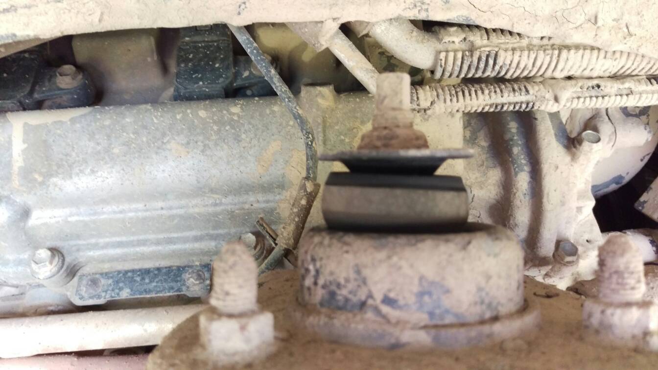

The saga of Bilcrap... Err Bilstein continues. The washers above my front shocks have completely bent upwards now. I replaced the drivers side with an old washer from my lca's but the passenger side nut is stripped and won't come off. Sooooooo. I hate Bilstein! Leaky, not valved right, not worth a damn! Never buying them again!
A couple additional thoughts about your wheel bearing and shock issues. Wheel bearing wise you're running a funky spacer/adapter/wheel setup compared to the rest of us. For bearing longevity you might want to look into going back to 6 lug wheels. Also you might want limiting straps so you're not slamming your shocks down that hard. They are preloaded quite a bit so even if you're not jumping, some unweighting of the front would slam them down.

I hadn't thought of the shocks having enough preload to push them up hard. That's a good point. That would account for the top washer bending over backwards.
