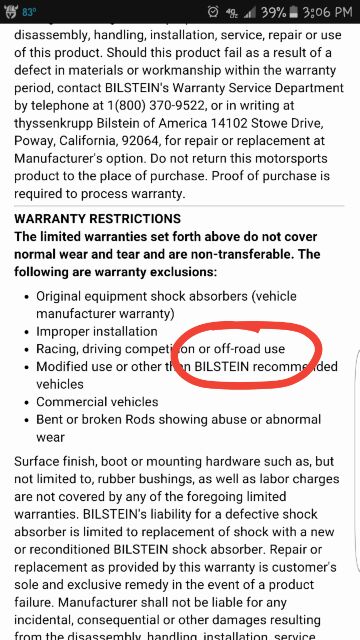

Also, for anyone wondering, another reason I'll never buy bilstein products. They advertise them as lifting and offroad shocks, but in there warranty info they will NOT warranty them if you go offroad at all. Completely contradictory to the purpose of the shock imo.

This is a classic CYA but they do cover all sorts of issues under warranty, at least they have for me in the past. Shock that is bottoming/over extending is an issue they won't cover but the usual leaky seals, losing nitrogen charge, etc are things they cover if within their warranty period.

Correct, but I blew the first set with stock coils. There shouldn't have been an issue. Same as the rears. I don't have more than 2" lift but if they are overextending that's an issue.

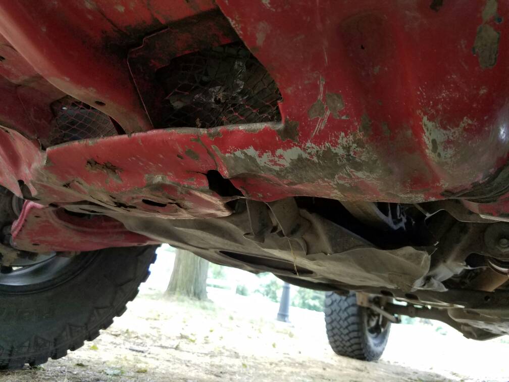

I'd say my skid plates are thoroughly broke in!

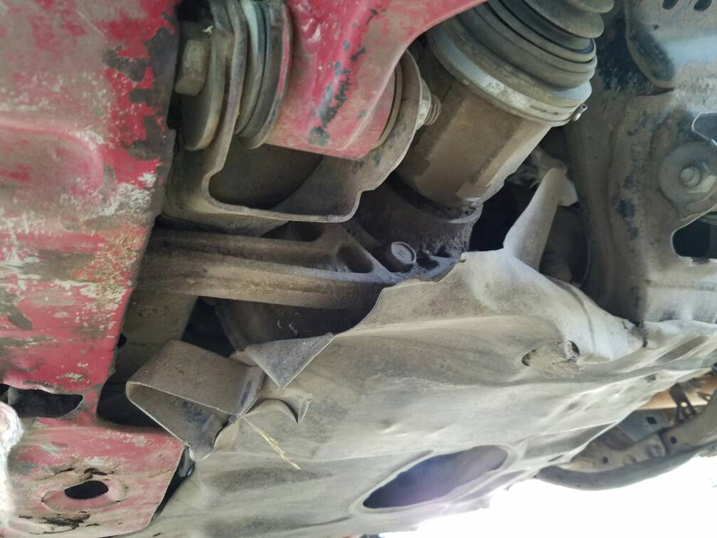

Looks like you have a small leak from the driver side of your front diff. Just in case you you didn't notice. You and I both know how expensive ECGS diff are lol. Keep up the good work man. Digging a all the black you added.
Hmm, I hadn't looked at that. Thanks. I wonder if it is runoff from changing the axle out twice now or if it's a small leak.

My guess is runoff, but it's easy to check. Just clean the dirt off, and watch for fresh oil. I'm sure you don't need the lesson, but I like to talk lol.
I was already thinking that! Lol. Was wishing I had a little brake clean left to spray it down with.

Dude. How do you have such terrible luck with Bilstein? Are you trying to warranty them at least?
They refuse to warranty. For on road use only.
