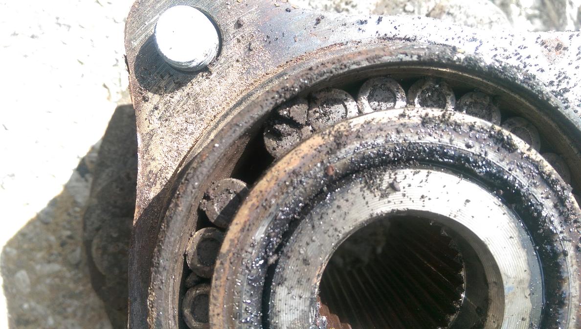

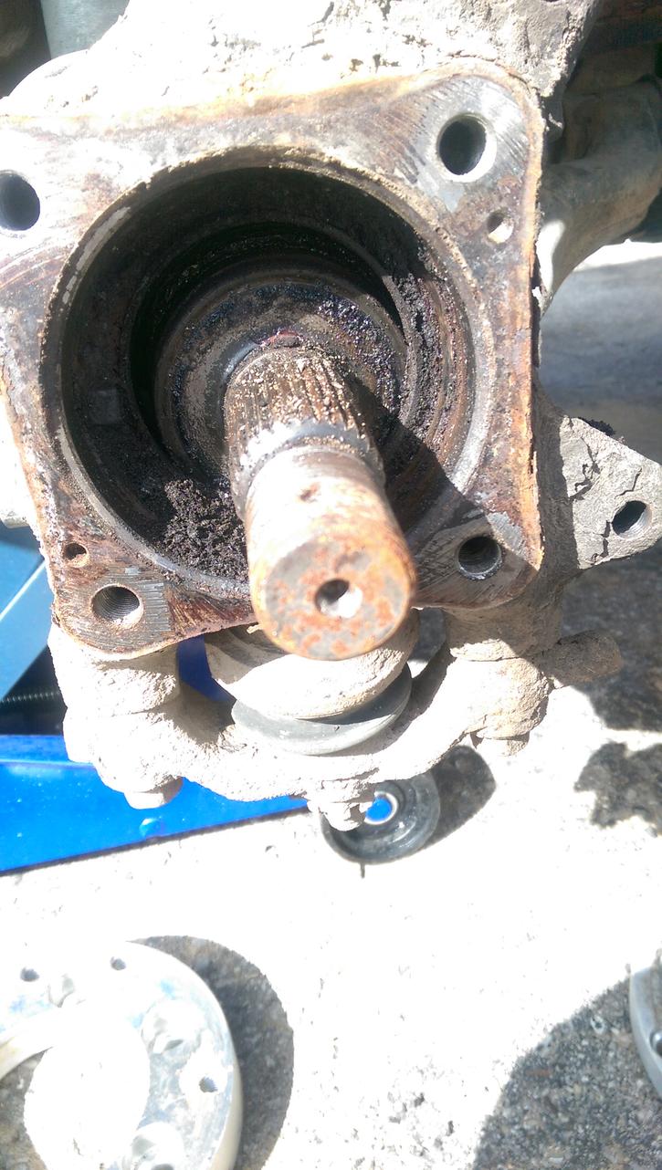

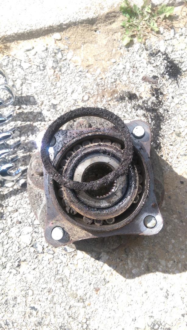

As you can see in the pictures I'm probably lucky the wheel didn't fall off or seize right up! It was totally done, tore up, and in desperate need of replacing. The inner seal was torn apart, was rusty and dirty and water inside too. It never made a sound, but I think this has been going out for some time now. Sheesh.

New bearing all installed. Went for a test drive and noticed two things immediately. First, when hitting the brakes before I was getting some vibration and also it would randomly pull to the left at times. Now it is smooth as silk, no pulling, no vibration, all great! Wish that damn bearing would've made some noises before it decided to puke on me.
