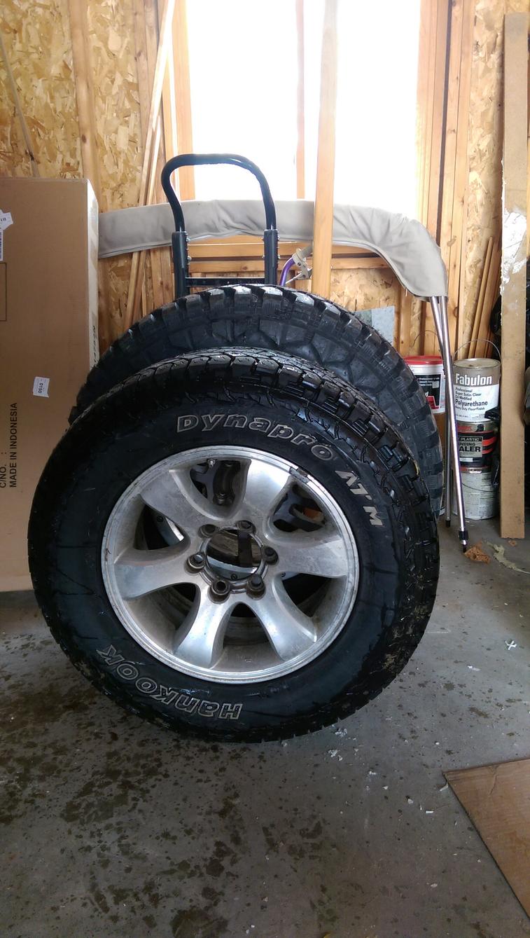

I was going to use them but they upped the price for 35's to where it's only 20 more for one of the tires I have listed above. Seems pointless to get them now.
Just bought 4 Hankook Dynapro MT's, 315/70/17, and will be here by thursday. I can't wait cause my tires now SUCK in the snow!!! Not to mention finally getting MT's on my truck and 35's to boot! :girl: whoot whoot

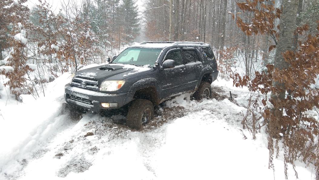

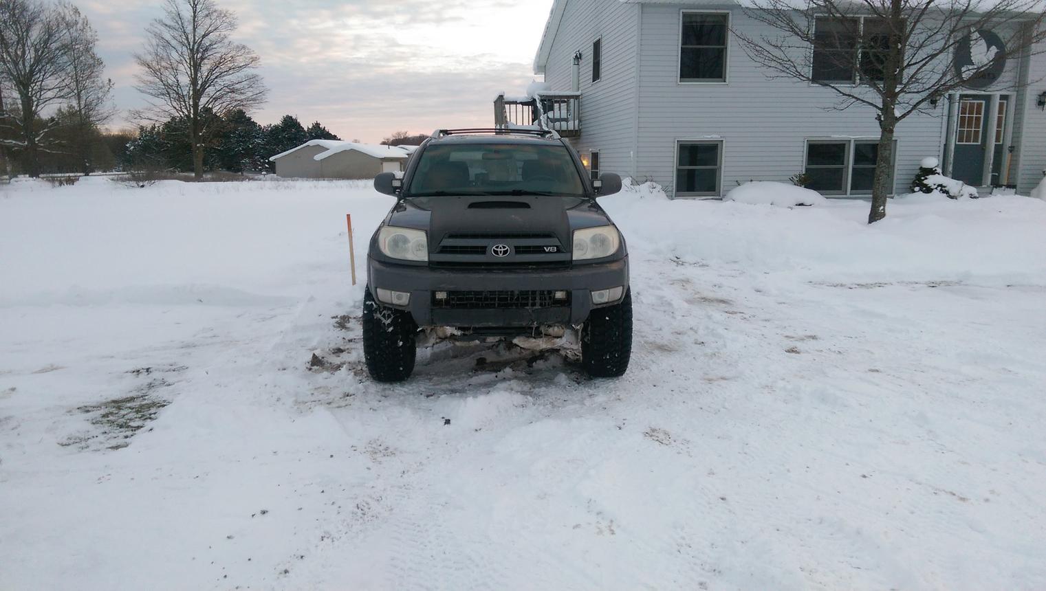

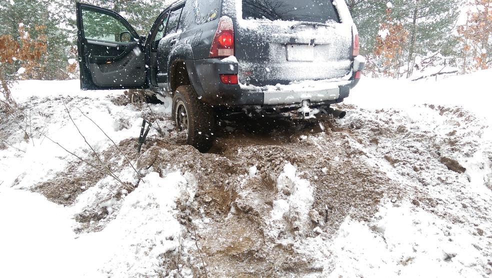

First stuck ever in Gertrude!

quite the dig in you got goin on, looks like a fun trip though in the snow!
Ya was all good til the passenger side front fell in the ruts, then the skid plate landed on the sand. Was all over at that point. Tires were free spinning. Lol only took a bump and I was off.

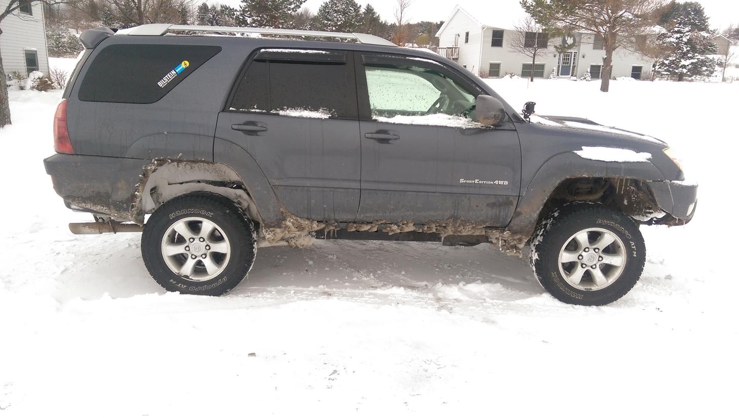

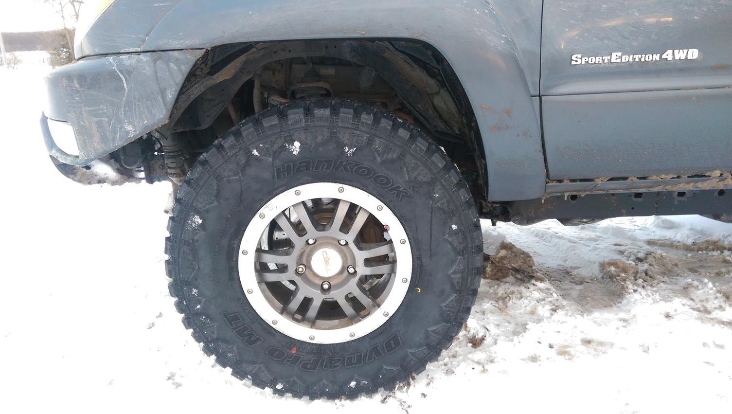

I have 2.5" body lift and bilstein lift set on highest level. Shouldn't be an issue, and I've already chopped my body mount and trimmed inside fender wells pretty good. Possibly need more trimming, won't know until it is mounted up. I also have wheel spacers that push tires out about 1.5-1.75 inches.

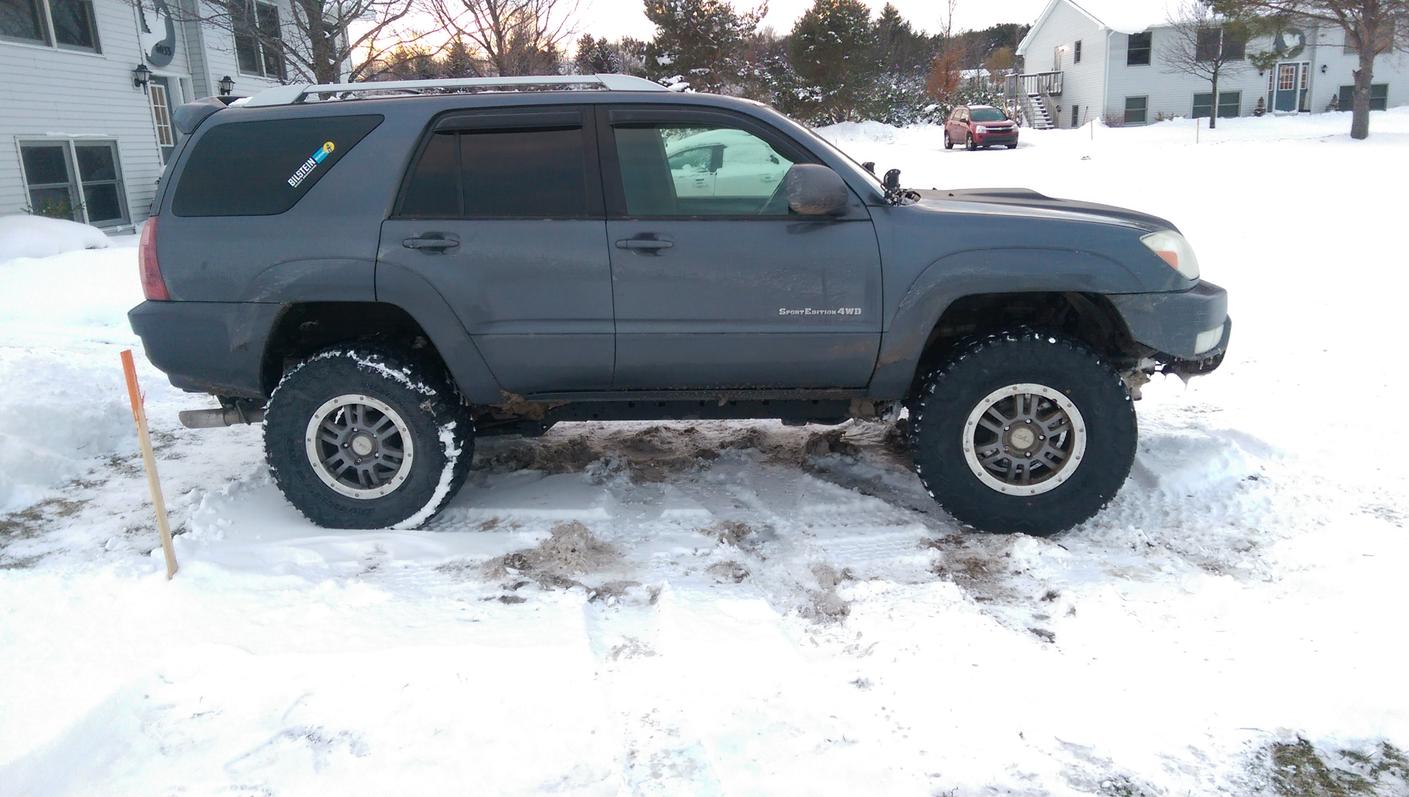

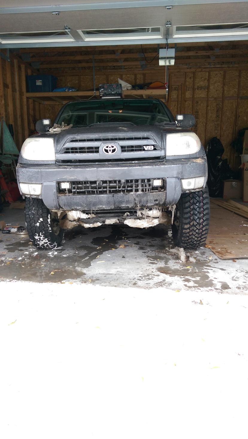

Here we go!! New shoes for Gertrude all mounted up!! Ride really nice, can barely hear them on the road, and damn aggressive!!!

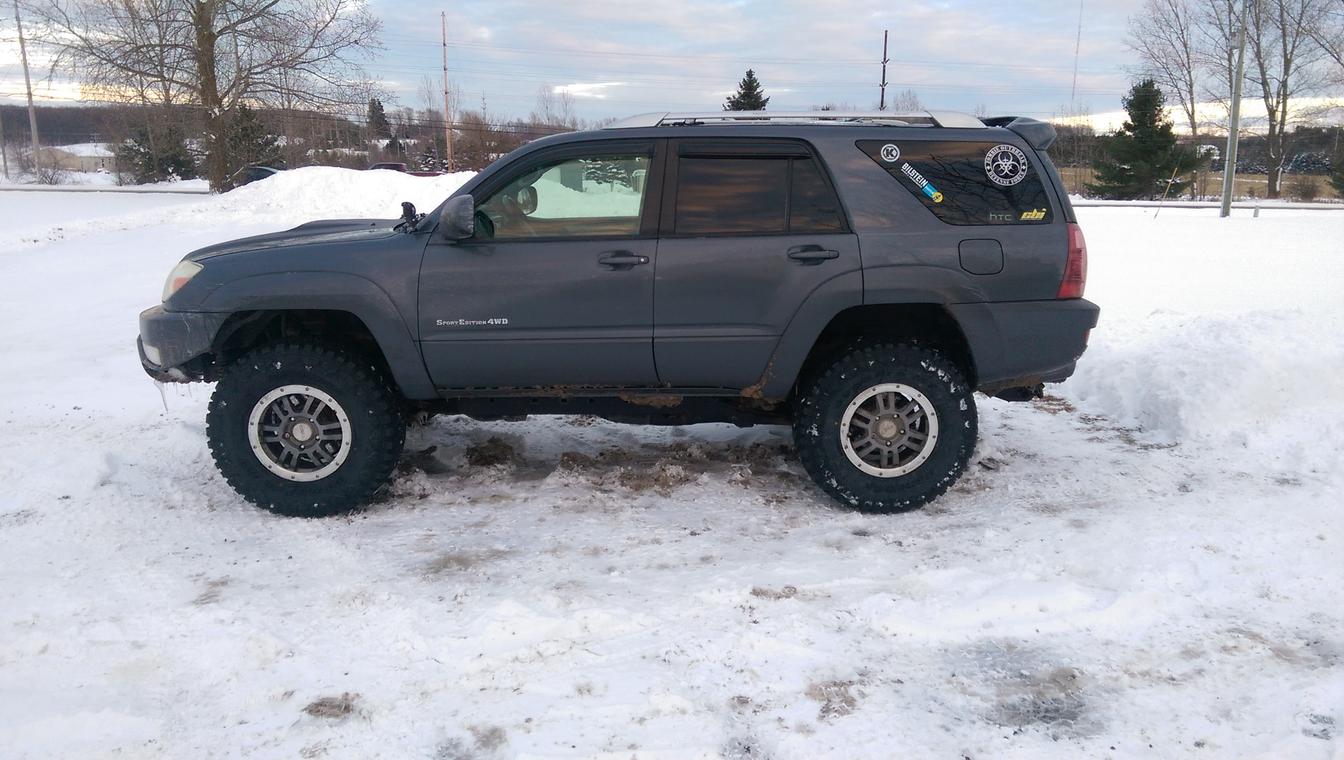

Height difference between 265/65/17 stockers and new 315/70/17 BEASTS!

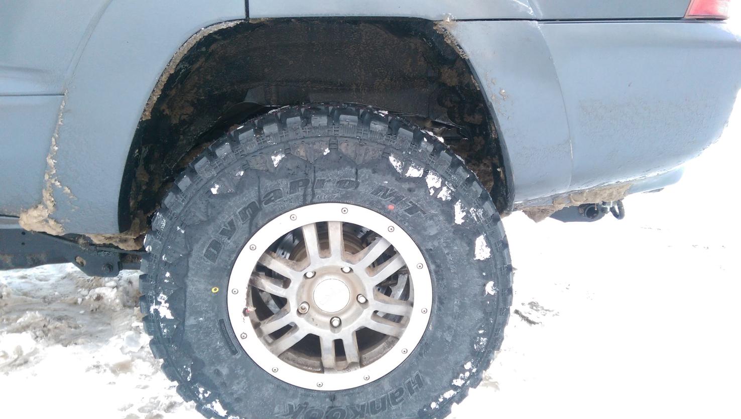

Can you confirm no rubbing at all whatsoever at full lock and or compression forward and backwards? looks just sick!
I had to remove the rest of the mud flap I still had on the rear and I had to trim the behind the front tires above the body mount where the pinch weld is. I expect I will have to hammer the pinch weld flat as others have done, but not an issue IMO. As for rubbing on anything else, with my spacers I clear the UCA with room to spare, don't come close to frame or anything else. I will get a chance to flex it a little over the weekend, then I have some friends visiting next week and we plan on going out and bombing around on quads and our trucks. I'll keep reporting back with any issues that arise, but seems to be decent so far with the minor trimming.
And that V8 don't care one bit about those big tires either! These weigh 71lbs where the stock size weighed 38lbs. About the only thing I notice, which I had with the 33's too, is that it takes more for it to kick into overdrive. It doesn't go crazy downshifting, just takes longer to kick into the final overdrive.
