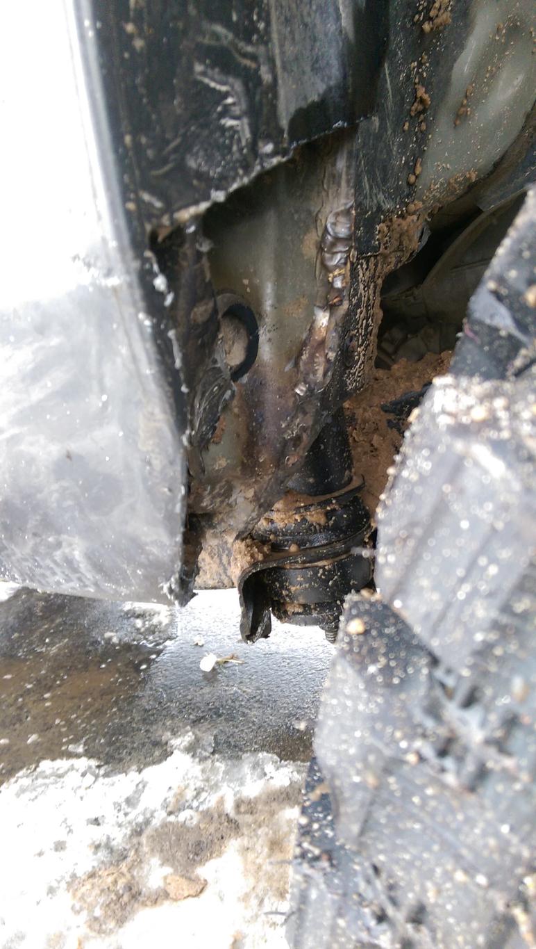

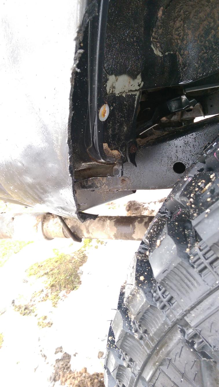

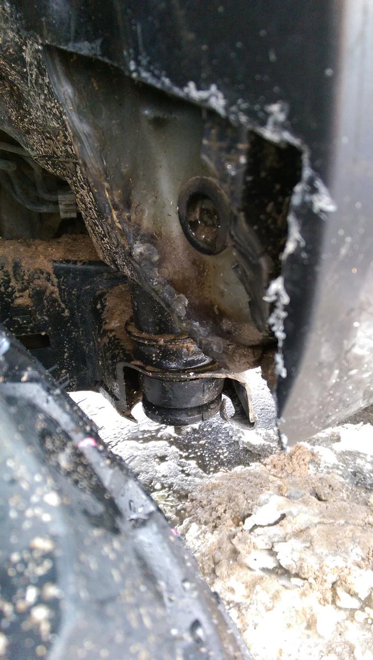

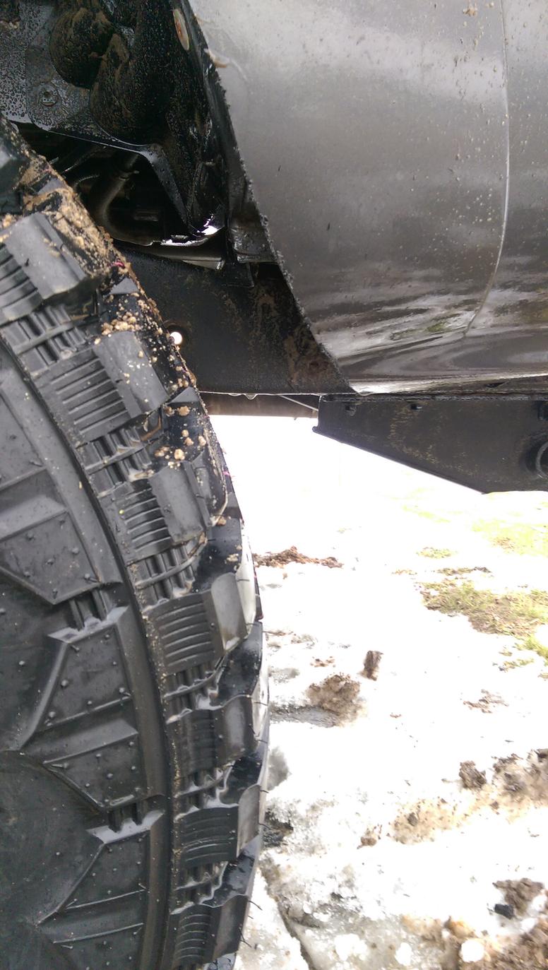

I had some time to go down a seasonal road and flex the suspension a little. I then came home and trimmed the rear fender behind the tire as well as the plastic on the front fender behind the tire, above the body mount. I then heated up the pinch weld and hammered on it a little. I need to do it more still but not to much. At full lock the tires are about an inch away from the frame so no issues there. I also have about an inch or so between the tire and UCA.

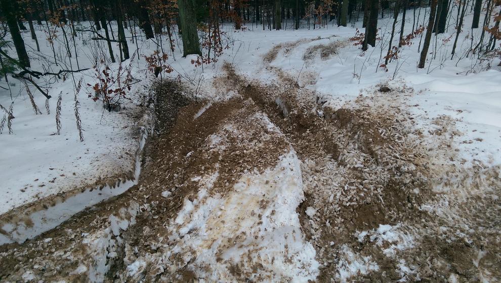

I was driving through about 5 inches of very wet snow, as it started raining lightly today, and had no issues with traction. I was throwing snow 20 feet in the air and if I punched it I would dig to dirt immediately! Lol, love these tires! I also checked the air pressure and the tire place had them at 50 psi so I lowered them down to 35. I might take them down to 32 but waiting to see how they feel.
Last, I drove to the spot I got stuck at the other day and blasted through it! I was throwing snow and sand everywhere! Was great times. My son had a grin from ear to ear too! :first:
