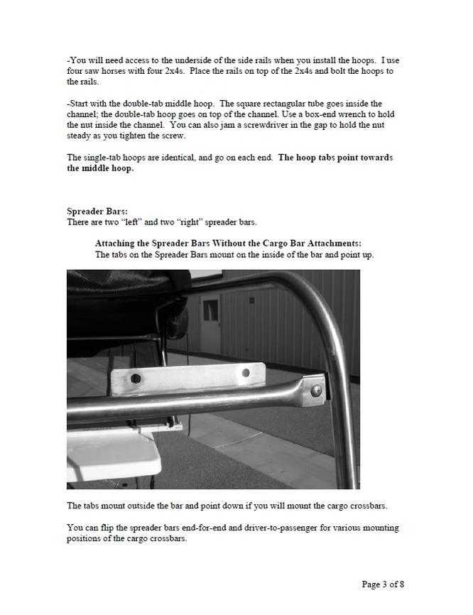

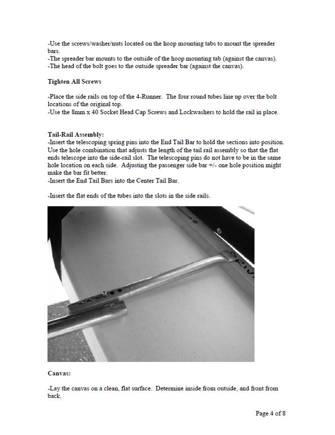

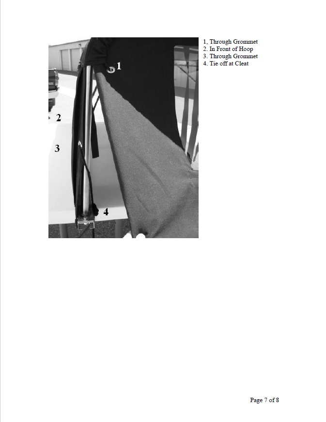

I posted the 8 pages of the install instructions .pdf file in case other member has the same issue than me.
