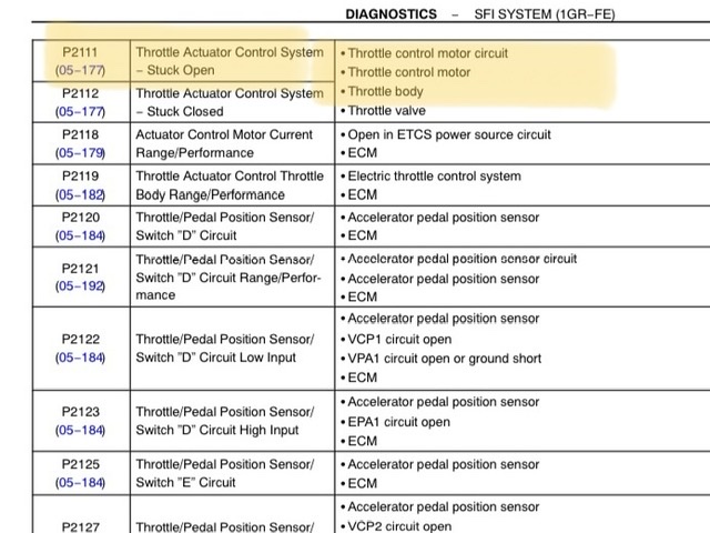

The SB would not cause that kind of failure. The error codes for the Accelerator Pedal Position Sensor are P2120 thru P2138.
As [MENTION=50279]spartacus[/MENTION] said P2111 is a related to a throttle body problem. See the DTC chart.

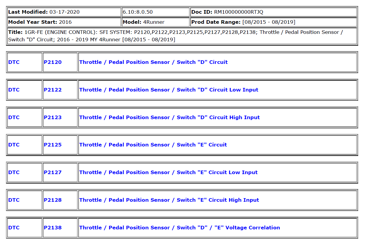

Let me try attaching those photos of DTCs again, FYI.
Does anyone know what causes the pics to post like that?
This is strange. When I preview them they’re ok. When I save them they’re ok. But when I refresh the webpage they’re gone.

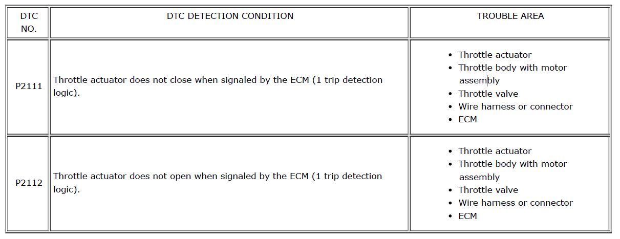

If you have access to the 2016-2019 Repair Manual the troubleshooting procedure is on pages 3788-3793.
The repair possibilities are:
Clean the throttle body with motor assembly,
Repair/replace ECM wire harness or connector,
Replace throttle body with motor assembly,
Replace ECM.
TOYOTA 2016-2019 4Runner Repair Manual RM27F0U
This is what the Toyota techs would be doing to diagnose your problem. Hard failures are easy to find following procedures. Intermittents are harder. But there is one procedure where they wiggle the connector/harness to try detecting poor connections. Hopefully they will have results for you soon.

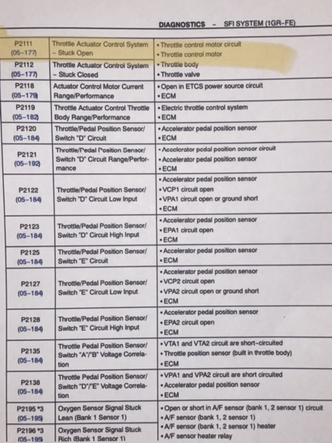

I also tried to post pics of the DTC charts and got the same results.
I’ll try to post them on my throttle body cleaning thread and link them.
384688d1626198692-maf-sensor-throttle-body-cleaning-be986e74-9541-4375-b14b-8bf54496b731-png
384689d1626198698-maf-sensor-throttle-body-cleaning-56630d6b-031e-4916-9fe2-34593d31949d-png
