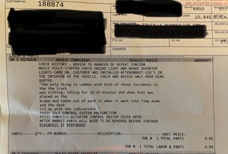

I agree 6 1/2 years with LED mods on my 2014, six months with same LED mods on my 2021 and now all of a sudden LEDs are the culprit my gut instinct tells me “HELL NO” !
Thanks for the suggestion …..
I’ll wait and see what happens, install one mod at a time if it doesn’t act up in two months.
By the way A Toyota corporate agreed when I called yesterday.
They stated, I need to remove all LEDs that were modded, return to OEM and see if it acts up again or they can’t go forward.
Will keep everyone informed “if/when” it acts up again!

So this is where we stand today.
Toyota will not move forward until I remove all LED bulbs from my Toyota truck that were not installed by Toyota, we will see where it goes from here.
