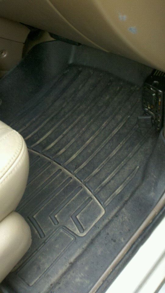

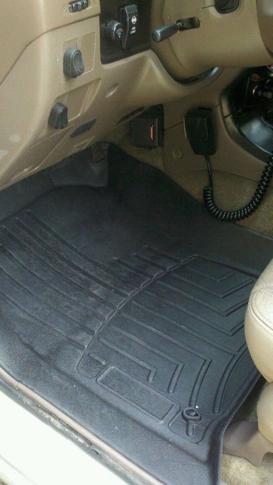

So....i really havent been doing much to the 4Runner lately. But, i dig score some Weathertech mats on craigslist a few days ago...also got some vent visors from the same dude. I broke both of the passenger side in channel vent visors a few weeks ago. These are not the in channel ones but will do, until i can get some replacements back from AVS.
Passenger side....

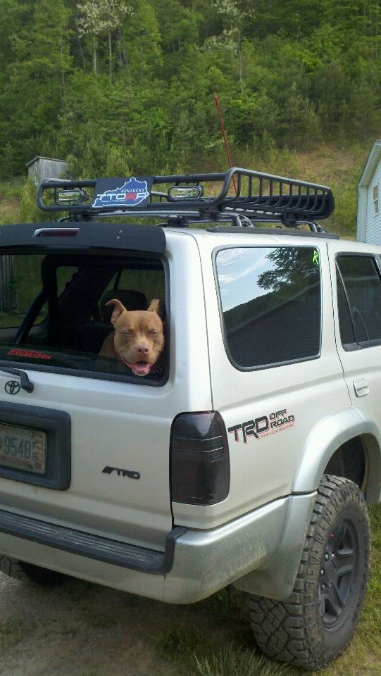

Khoas in his favorite spot!
*I really hate the VHT on my tail lights!!!!

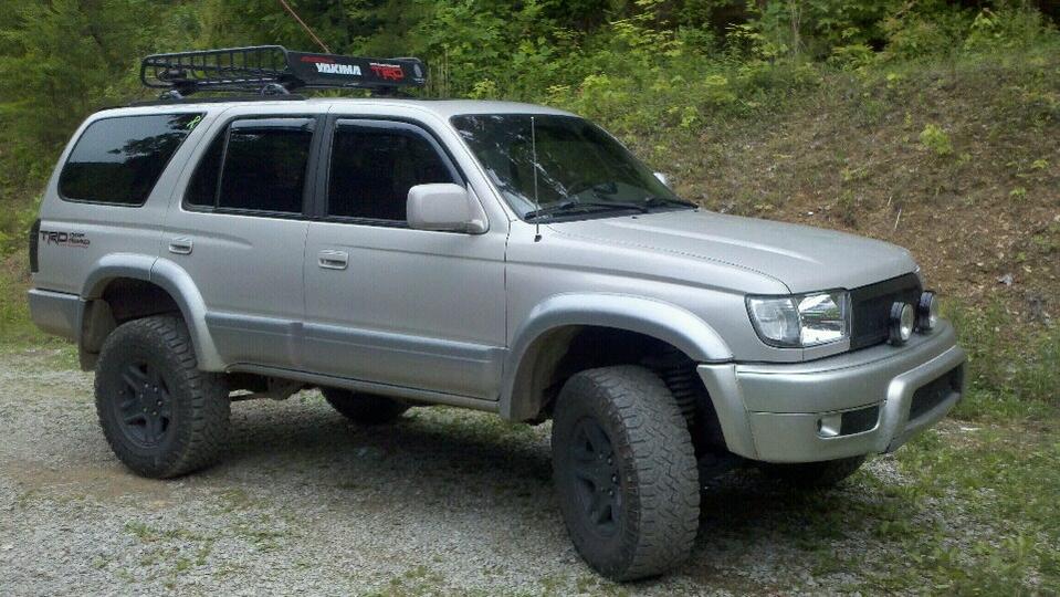

The most current pic of 4Runner....
Ordered headlights from Eagle Eye, they are defiantly better than my old headlights... I also installed some KC lights on the front and took off the PIAAs. I plan on moving them to the lower valence....just dont know if that the best place for them....

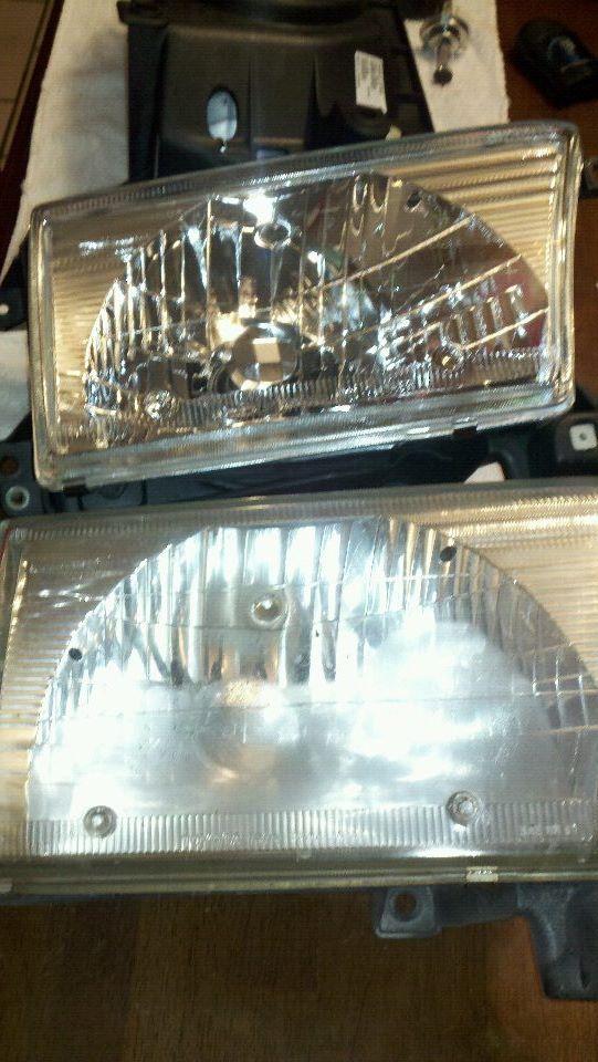

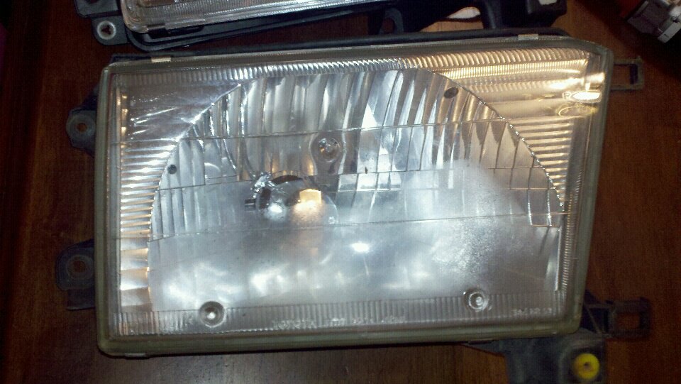

Here is a comparison between the very OLD...and NEW!!
These have definately been through hell....BUT, i smell a retrofit coming!! HOPEFULLY....
I am still considering a set of HIDs. BUT, I really wanna do a projector retro fit. REALLY REALLY BAD!

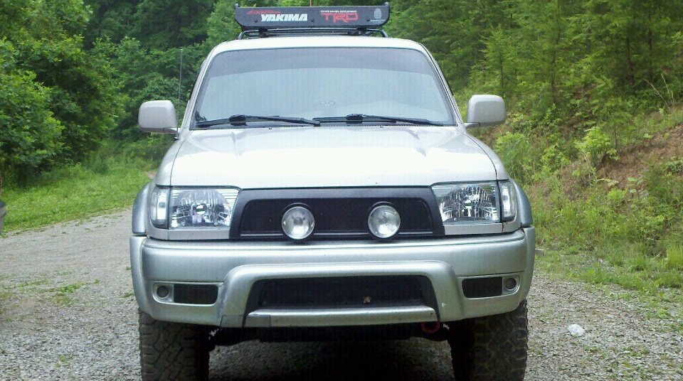

Nice build! I have been searching all week for someone with lights mounted on the bumper like that. Can you take some closer pictures of how it is mounted? Maybe a quick write up? I'm getting some lights for my birthday next month and wanted to mount them like yours! I really like the look.
thanks man...i dunno about a write up but i can get u some quick pics of them closer up.
basically all i done was placed the lights where i thought they looked good and made sure it was centered up with the grill. Then i took a sharpie and put a small dot where the light bracket was sitting on the bumper. Then i removed the grill so that i had more room to work. Then i made a small pilot hole with the smallest drill bit i had (Metal bit) TIP...drill slow so u dont chip paint and so drill bit doesn't slide. Then take a drill bit the size of the bolt u are using to mount ur lights with and drill the hole the rest of the way out. Mount ur lights, aim them and enjoy. Not mucha a write up but i am pretty sure u can get the picture....:thumb:
