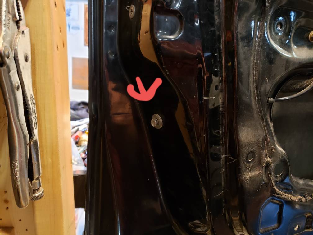

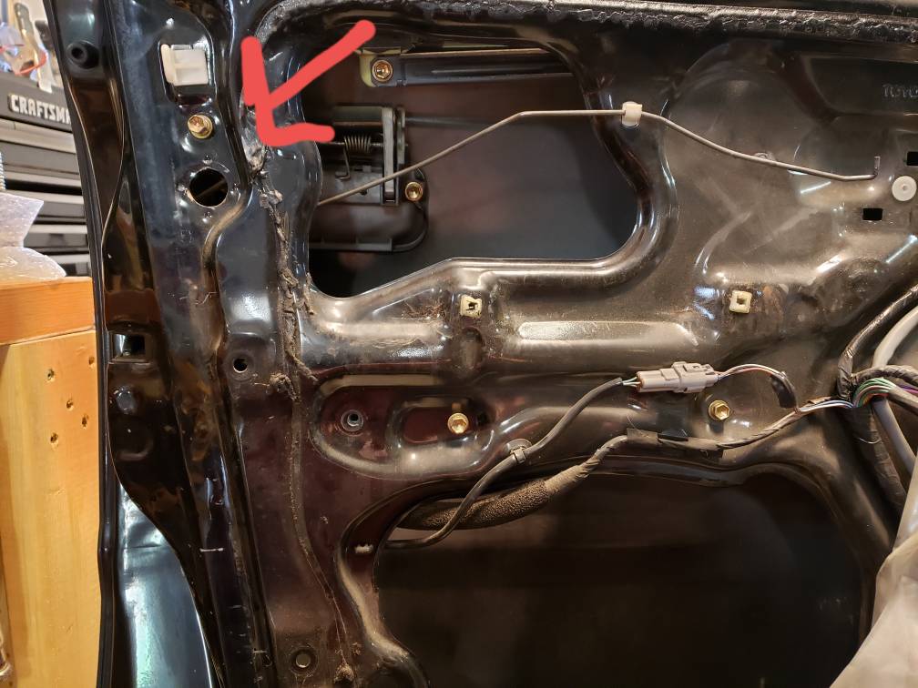

I just worked on mine today, got 3 of the 4 done. To make your life easier, remove both bolts that hold the window track so you can just move it out of the way (front doors). The actuators just slip out and in easier by doing this. Also make sure you glue the 2 pieces together. If you don't you will be taking them back out after a few rounds of clicking the locks. (Ask me how I know)
