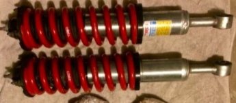

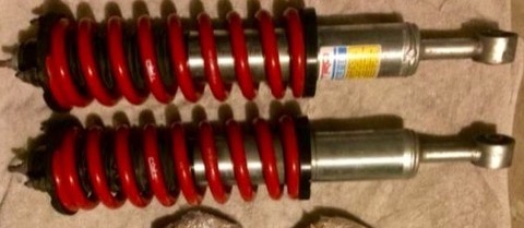

Im sorry to bring a thread back from the dead but i've come across a 16/17 Tacoma TRD off road shocks with leveling kit on it already. -
From what I've read over the last few pages is the rears are a little soft for the 4runners? It's not going to break the bank if I purchase them, I just don't want to get everything taken apart, only to find out I'll be doing the rears again.

From my experience, the rear is soft, but not unbearably soft. I would try it out and see how it feels. Worst case, if you don't like them, they will be very easy to swap out, like maybe 15-20 min per side, because you'll have loosened all the tough bolts from your old setup already.
Other than that, I'd be careful with that much spacer in the front, it may put you over a 3" lift, which will make it impossible to get caster even close to spec, may end up with negative caster. You'll also need more height in the rear, or the front will be higher than the rear (bro stance). I'd recommend some FJ springs w/ Daystar 1.5 spacer or Icon 2.0 springs in the rear.
It's a totally different ride, but much more off road capable, that's why I love it.
On my 07 I ran with that same exact FJ setup and it was perfect. I just got the 03 and came across this deal... While I'm very familiar w/ the FJ setup, I have no experience w/ Tacoma setup. I do have a set of FJ rear springs tho, but I was also curious on how much that front end would lift tho.
