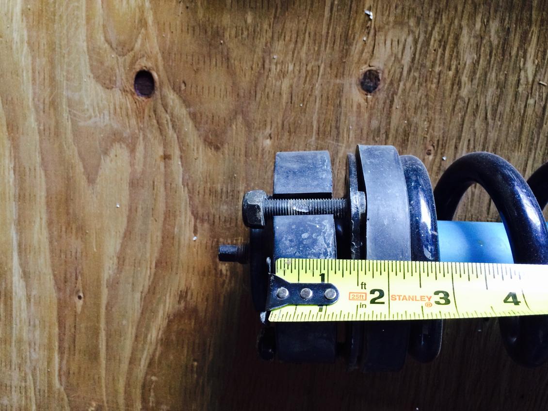

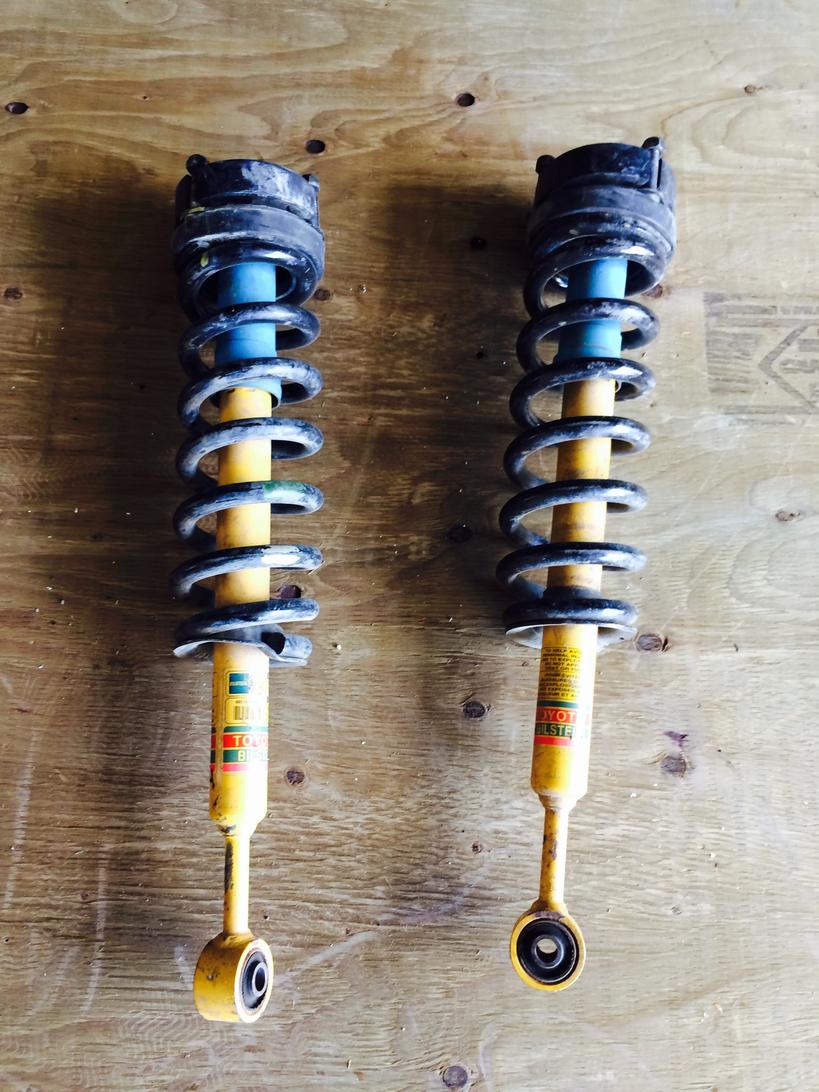

I got some front struts off my trd 05 tacoma sport with a daystar leveling kit already pressed on for sale if somebody wants ? Its the 1.5 spacer lift.
