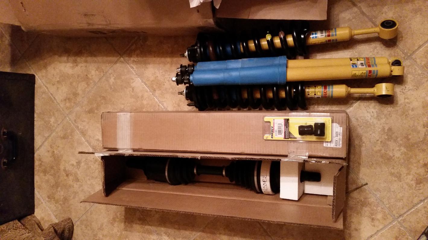

Just got my 2006 SE V6 4x4 back from the shop with a Tacoma suspension swap. Front struts and rear shocks from a 2014 Tacoma TRD Sport 4x4 with rear coils from a 2014 FJ. My XREAS must have been beyond toast because the ride is like new. It is very level with about 1.5 in the front and .5 in the back. I am still considering the sway bar bushings upgrade but am a little hesitant here in Minnesota, not sure how those will feel in -30 degree drives. Can't thank you guys enough for all of the great info. Also did the HCF delete and AFE dry filter. My truck is running smoother then it has in years. 140000 on the clock with no major issues now that the suspension has been renewed. Next up is the spidertrax wheel adapters for a wider stance. :rockon:

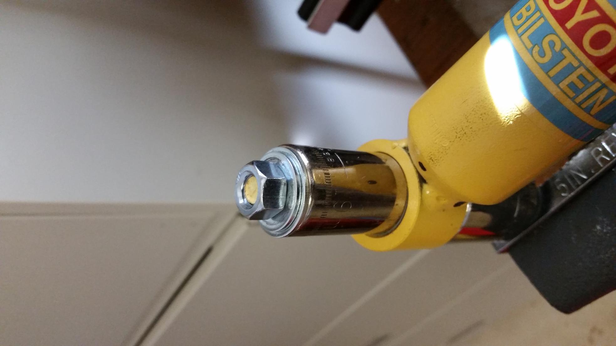

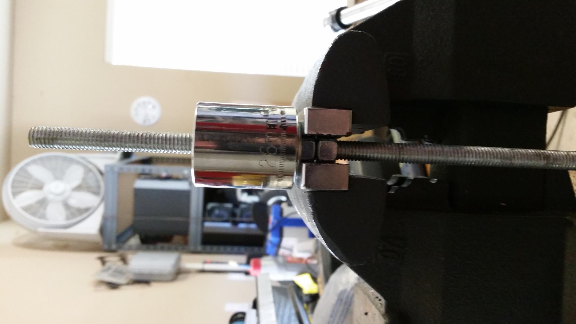

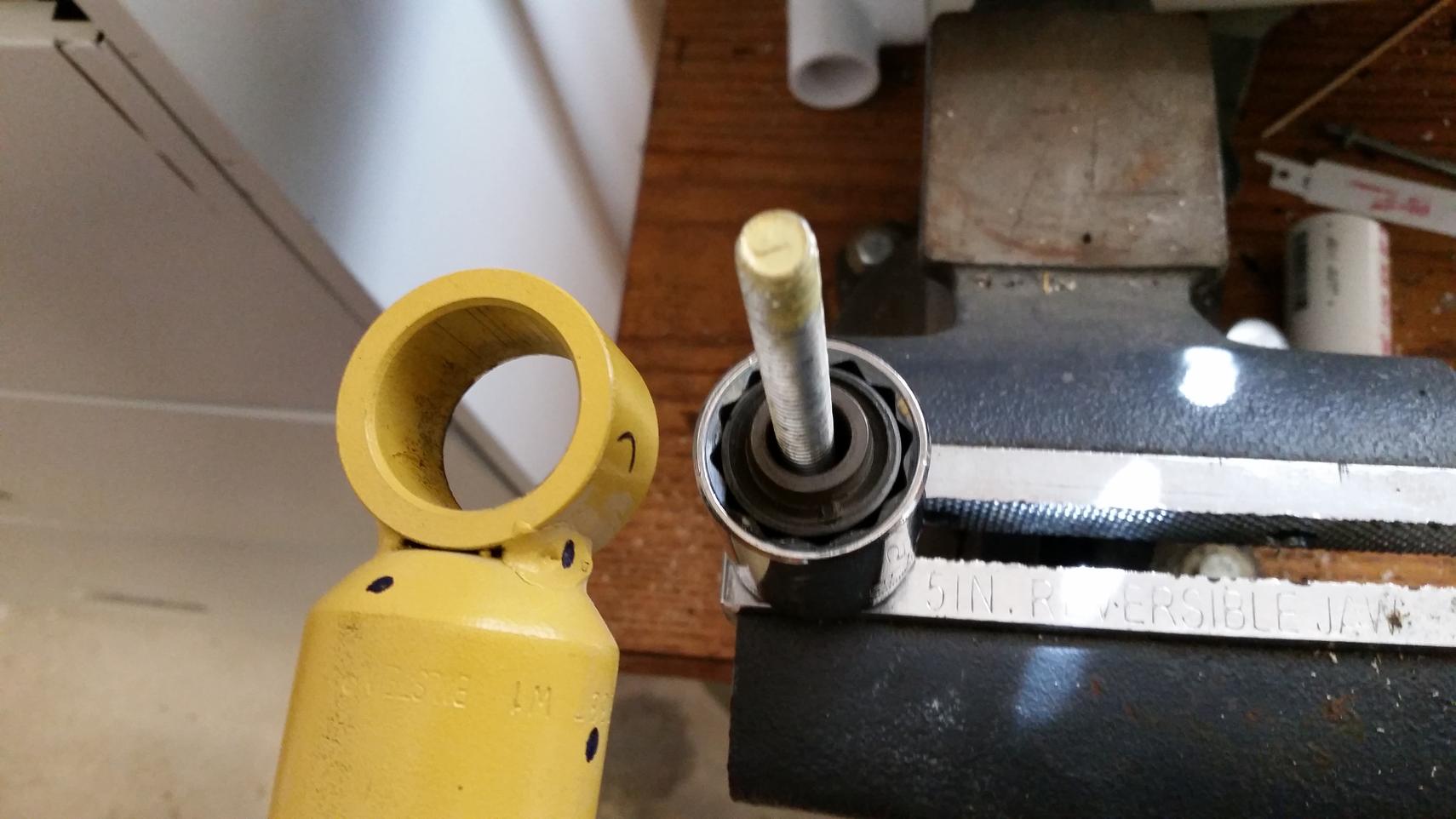

Anyone figure out how to press the bushings out of the rear shocks? I ordered the new ones but can't get the originals out.
19 & 26mm sockets, threaded rod and some nuts and washers...and a vise helps.
