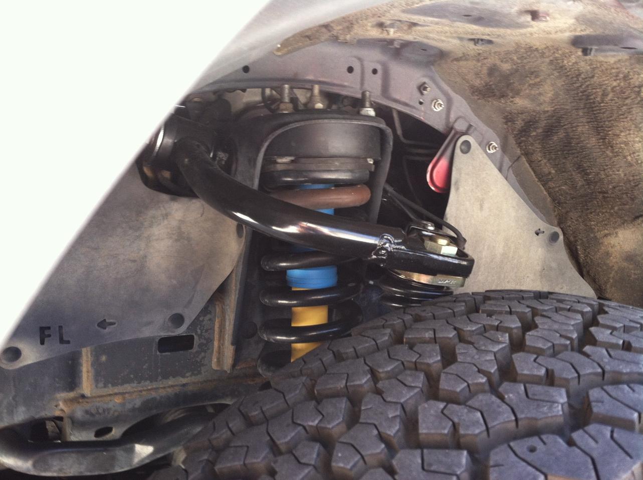

Highly recommend this set up. I did the same thing, got 1.25in of lift from the tacoma coils and a slightly firmer ride over the stock springs. Also have the daystar 2.5 spacer lift kit all the way around and the truck sits even on all four tires. Think it sits 38 inches ground to fender.
Good lookin rig man. Any clearance issues with those tires?
