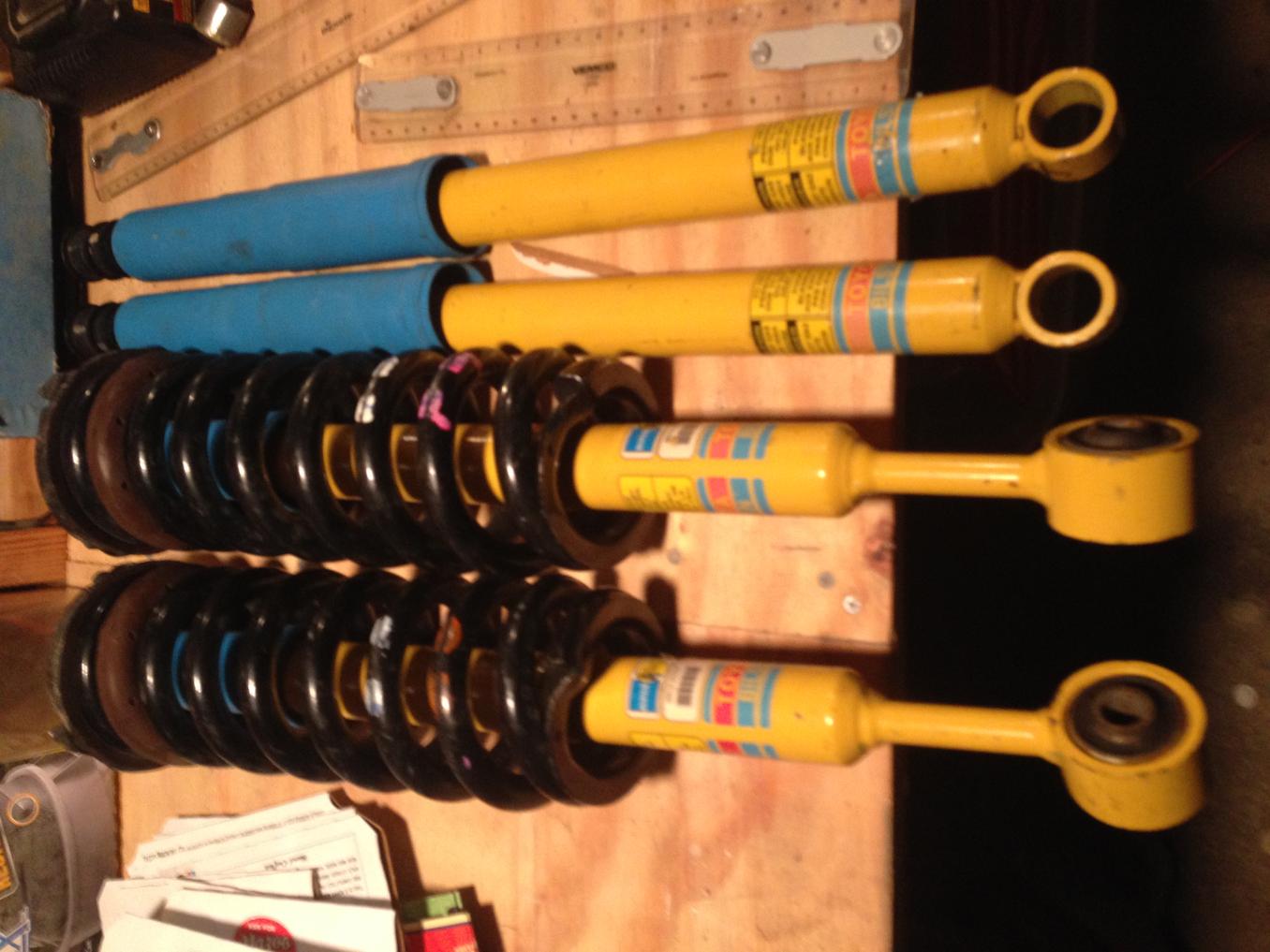

Xreas Delete + TRD Front Struts
Hey guys,
Got the wife a 4runner with 118k and knew it needed new front struts. What I did not realize was that bad Xreas requires full replacement.
So after some research, I will be ripping entire Xreas system out and replace with these 2011 TRD Tacoma front shocks + springs and rear shocks with the bushing replacements here Energy Suspension 9.8108G - Shock Bushing Set | O'Reilly Auto Parts
**UPDATE**
For some reason the shop said the rear shocks would not fit, saying the bottom eye was way too small... Has anyone else had any issues on 09's? Anyways went ahead and replaced with monroe oem replacements. Also have 05 TRD Tacoma that will utilize the rears.
Will update measurements soon...
Total cost : $546 including alignment
I know I got a little ripped, but I am liking the new level look plus ride is better than blown xreas...
Thanks for all the info guys. Especially ARK_SWAMP_RIDER!!
Cheers guys!
