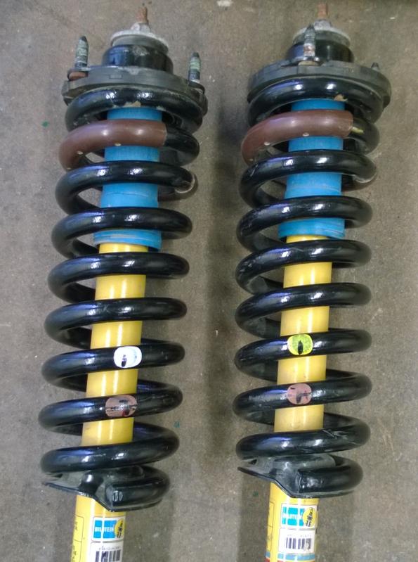

The ES bushings don't appear to be 100% symmetrical, is this on purpose and does it matter?
Anybody can tell which is left and which is right? I'm thinking the one with the yellow dot is the driver side strut but not 100% sure.
Based on the FJ color codes, I believe that is correct. You may have to peek under a tacoma to verify, that's the only way to know for sure.

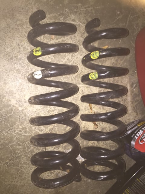

Guys can someone tell me which is the passenger and which is the driver side spring? Got these from a 2015 trd sport with less than 5k miles on it.
