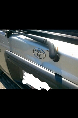

I bought a 99 and didn't test the tailgate window before I bought it.stupid me.
There's a small dent on the back where the Toyota emblem is. Literally a cm to the right. it's about quarter in size and 1 cm deep. I was wondering if its the small dent that's preventing the window from rolling down more than an inch.
Is it easy to access through the panel to push the dent out?

If things like that can stop the window on it's tracks then im starting to think the dent is the problem.

Went to take a picture. . I guess its bigger than what i remembered and closer to center of emblem

Went and took the interior panel off and it is impossible to reach the dent.
By looking at all the tracks and gears, i do not see any obstructions. I even thought it might have been the rear wiper not seated correctly but it made no difference.

Update: for anyone that has a ding or dent on their lift gate and the windows doesn't work or roll down much- for me, it was the wiper motor that obstructed the window from rolling down. I pried at it to push it back into place and it was fixed. Took some time to message it back.
