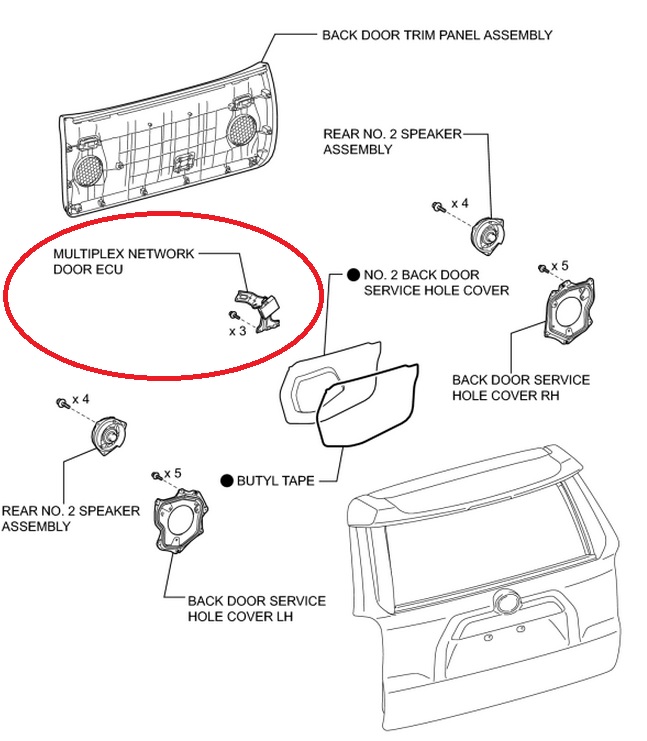

Here ya go buddy, I was pretty sure the multiplex ECU is in the tailgate, but I think this finally confirms it for us. Hope this helps you out with troubleshooting this weekend!
Wow - That's odd! I wonder where the "Back Door Power Window Regulator Sub–Assembly" is then? I only see the single box in the tailgate your diagram calls the "Multiplex Network Door ECU".
The FSM shows the Front L/R and Rear L/R window switches all feeding into the "Multiplex Network Door ECU". Strange indeed. Maybe it is a multi-unit "Networked" box (one per door?). But then I'm still confused on where the "Back Door Power Window Regulator Sub–Assembly" is then? The FSM clearly shows them as 2 separate boxes...

EDIT - Ah - I think the FSM calls the rear-window MOTOR assembly the "Back Door Power Window Regulator Sub–Assembly". They call the motors the "Power Window Regulator
Motor Assembly" for the front and rear doors - thus my confusion on what a "Back Door Power Window Regulator Sub–Assembly" actually was. Makes sense as there is no other mention of the rear-window motor (didn't even realize it was "missing" with my theory of what was what in the FSM)...
So it does look like there are multiple (at least two) "Multiplex Network Door ECU's" which are (obviously enough) networked in some way! Possibly just involving windows with more than 1 method of control (The master driver's bank for the FR/RR/RL windows that end up with two controls per window, and the console switch + rear key for the rear-window). The FSM is starting to make A LOT more sense now. I'm an Audio/Broadcast Guy, not a "I have a knack for modern vehicle electrical systems" guy :p
This being the case (and my eyes being opened!), it does appear I could have easily cut one of the wires from the console switch to the tailgate-mounted "Multiplex Network Door ECU". This would result in the key working, but the console switch not. Perfect!
