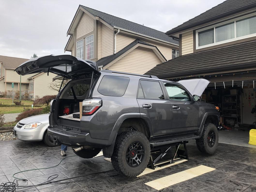

Get the 7000 and suv blocks - I’ve had mine for about a year now and am totally delighted with it. The 100lbs is not an issue as you never pick it up - just rolls on the wheels on the end. You don’t need the pinch weld blocks as it is better just to cut a slot in a hockey puck and save the money if you need it for a vehicle with no frame rails You use frame rail on 4Runner. I have no use for the plastic blocks it comes with as if you try and stack these on the suv blocks it wobbles too much.
Anyway I do all my own maintenance and the Jack will make it so easy as I get older. Best bit is greasing the prop shaft as everything just rotated and turns a fussy job into less than 5 minutes

thanks man.
are you jacking in the driveway b/c of clearance issues in the garage with the garage door opener?
right.. jack on the frame rails
are you using the wall mount hooks? i have a driveway where i have to turn into my garage ... so not feasible for me to leave the quickjacks in my parking bay
Yes - truck has 3” lift as well - no way it works in my garage sorry to say. No hooks as I have the 2 ramps wedges safely in a convenient corner.
