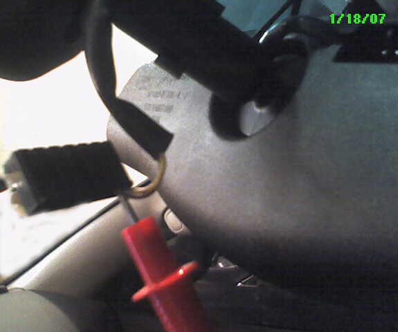

Photo and notes
Do this at your own risk.
Ok, re-installed the Valentine this evening. I forgot how easy it was. The mirror has only two wires going into it. The yellow/white one is the 12v + pos and the grey/black 12v - neg.
The Valentine One doesn't care about polarity (it takes care of adjusting the polarity internally so there is no concern with postive or negative on the wiring harness) , other detectors might, so make sure you know your device and verify the positive and negative wires before connecting anything.
I just cut a short piece of telephone wire(about 6 inches, tinned the ends with solder, then sandwich the wires in with the connector and snap in back into the mirror.
Done in about 5 minutes without tearing the truck apart.
Enjoy!
