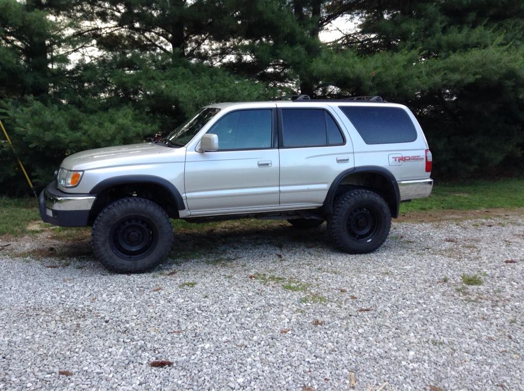

Been a while since this has been updated. Swapped out the a Tundra wheels for a set of FJ steelies.

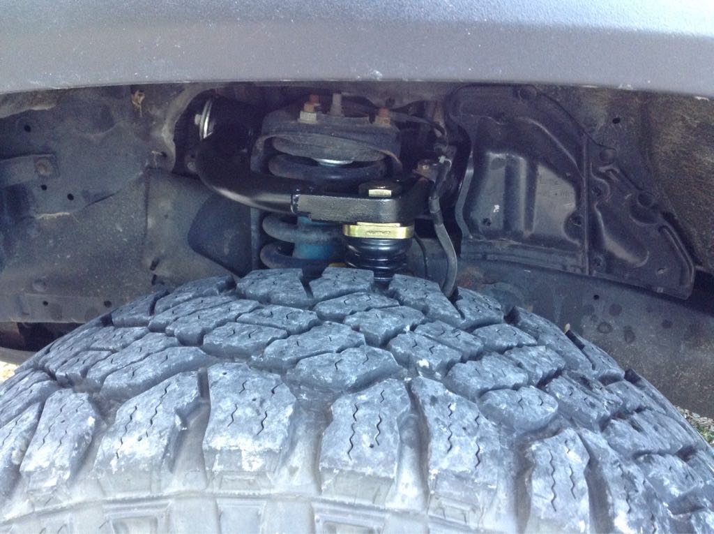

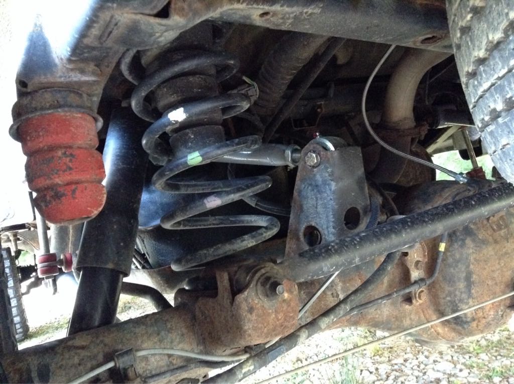

Finally installed my extended rear brake line, replaced rear brake shoes and drums. Replaced front inner and out tie rod ends, and also installed Light Racing UCA's.
And installed the custom rear UCA's I had built about a year ago
Nice build so far. Good choice of tires, tho I was sad to see the beautiful Sequoia rims make way for the heavy steelies :(
Thanks. I wish I went with 285's in the beginning, and plan to when I can.
As for the wheel change, I wouldn't want to damage the Tundra wheels when offroad, so I picked up the steelies to use in case of damage.
Good news for someone is that a set of 5 Tundra split 5's will be for sale soon.

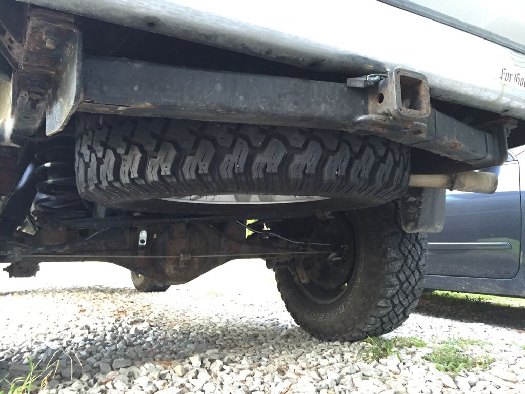

Found a smoking deal on a Cooper Discoverer S/T with 14/32 tread depth to use as a trail spare. Doesn't fit well enough under the truck for me, so I'm going to fab a mount in the cargo area with the roll bar
