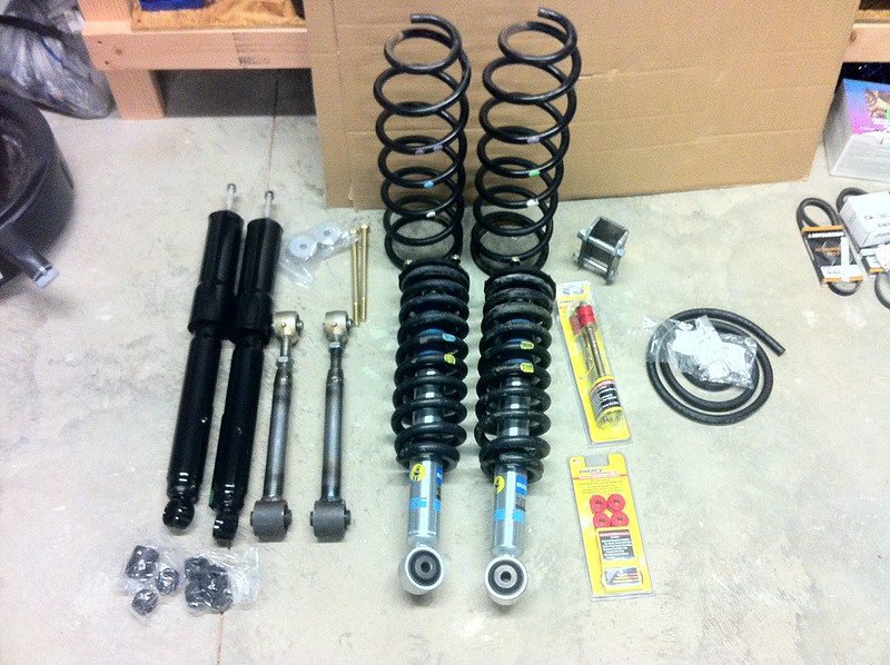

Lift consists of:
TRD springs mounted on Tundra 5100 billies, 2nd perch
Toytec diff drop
LC 8 Wraps ( Purple, Green, White & Double Purple, Dark Blue, White )
LC OE Tokico black shocks
Toytec panhard drop bracket
Energy suspension rear sway bar links
Rear adjustable UCA's
Diff breather extension
So ready to have this installed.

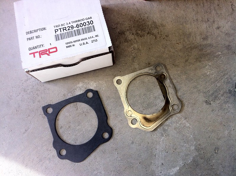

Small update today. Cleaned the throttle body and mass air flow sensor. Replace the throttle body gasket with the TRD "O" gasket. Started on replacing the fuel filter, however, the fitting for the outlet line is rusted and is rounding off. (yes I am using a line wrench. 10 years in the industry has taught me a few things). Since the line is cheap, I am ordering it and will just have some fun replacing it.

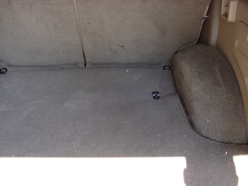

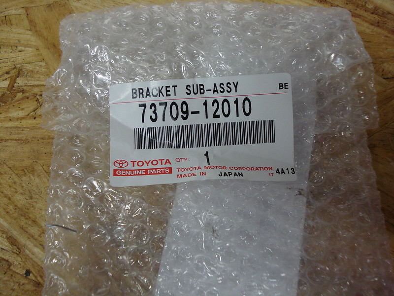

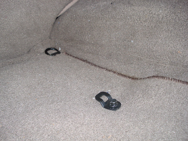

Worked on a few more things today. First was installing an add-on offered by Toyota. It is a child seat tether bracket to anchor forward facing child seats. I will be needing it eventually as the kiddo is growing like a weed. Fairly easy install. Lift up the carpet in the cargo area on the passenger side and locate the hole that is already there. Poke a hole in the carpet at that spot, screw in the bracket. Done.

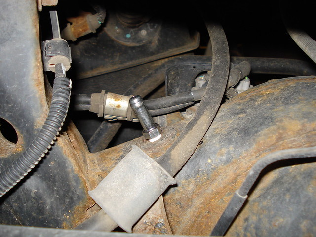

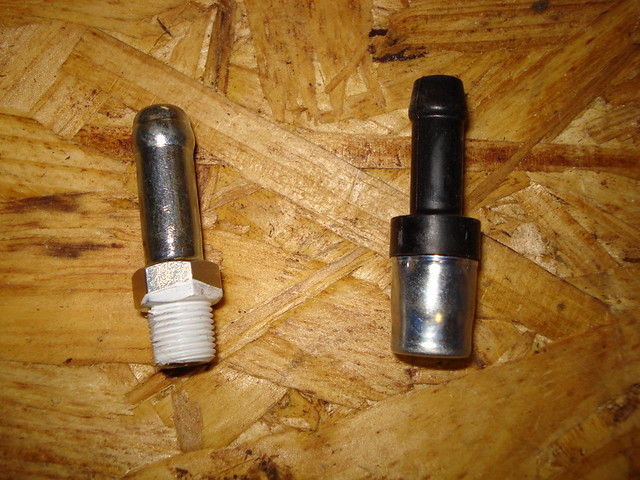

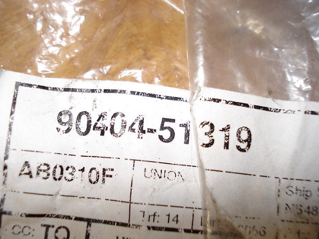

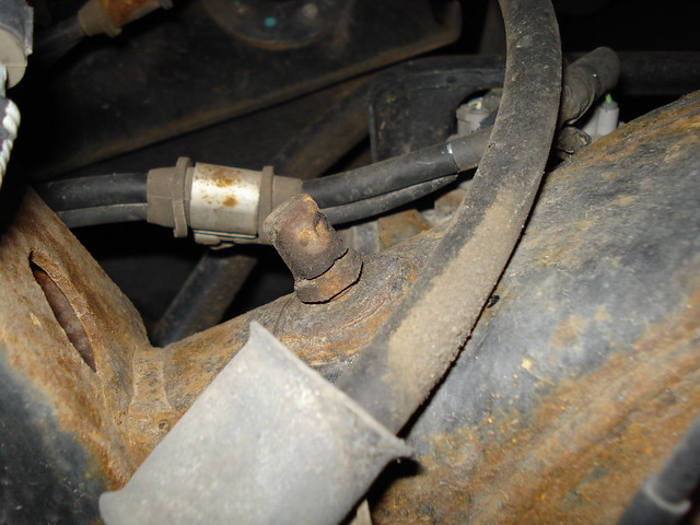

Up next was finally installing the extended rear diff breather.
Left is the union after I added some Teflon tape, right is the new breather.
First, I located the old breather, removed it, and installed the new union.

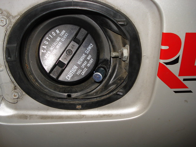

Next I removed the 2 bottom clips holding the fuel filler tube cover on, as this will make it easier to route the hose. Then I poked a hole in the gas cap area and started pulling the hose through with the new breather installed.
All done.

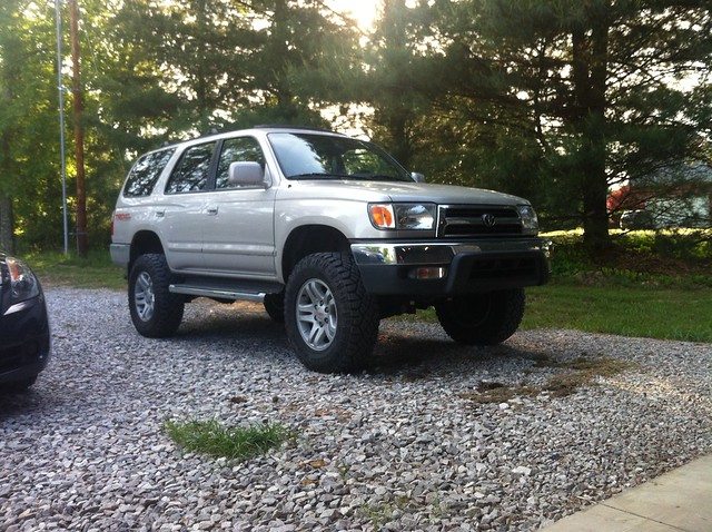

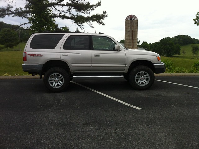

Lift has finally been installed. Need to weigh the rear down some, create a pair of extended swaybar links for the front, and replace the swaybar bushings with polyurethane on the front and rear. Then time to save up for some sliders to get rid of those nasty running boards, gotta keep the wife happy.
