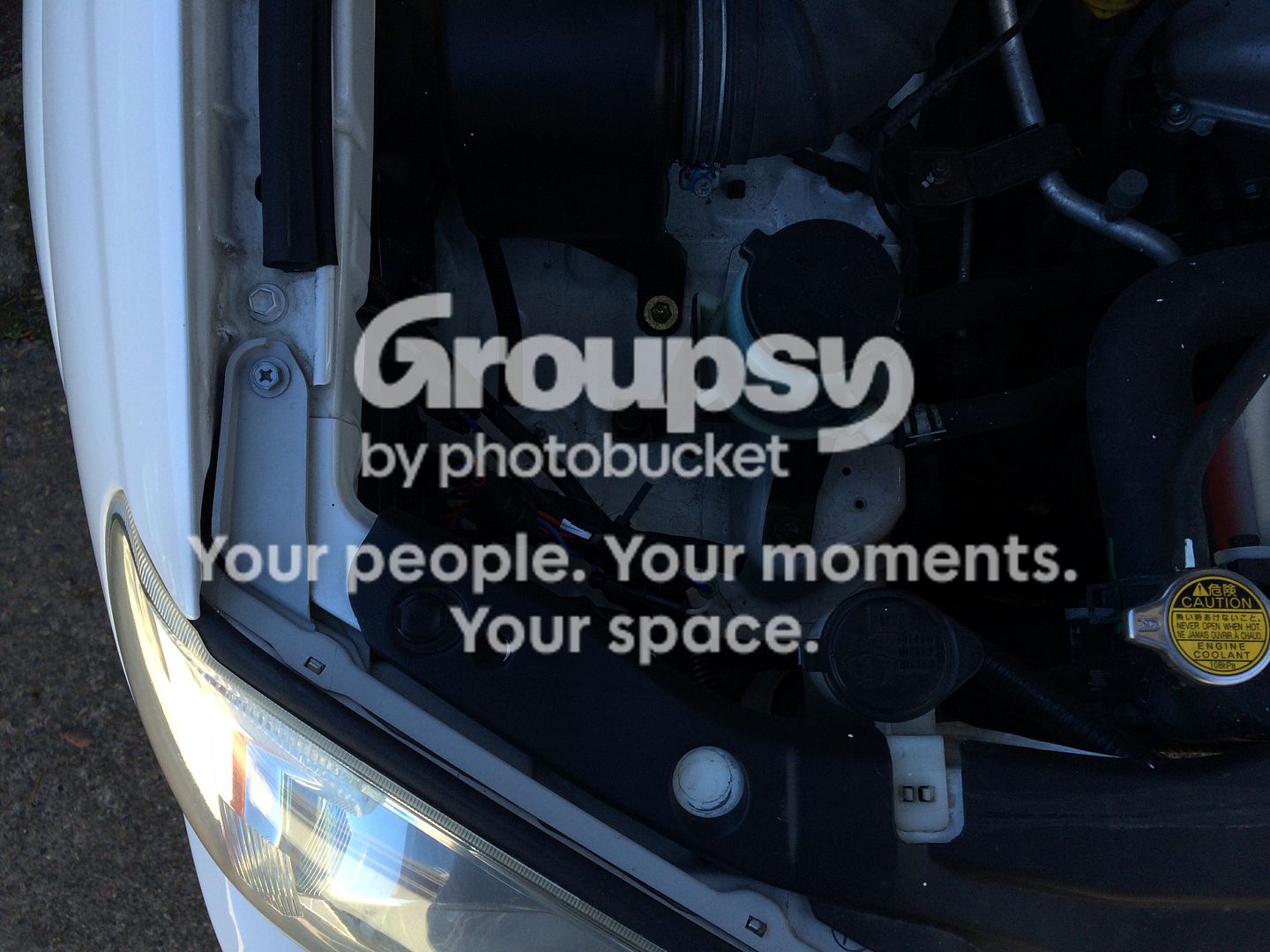

Here is a picture of the front of the runner. Do you guys see the h.i.d wiring? I hid it up under the core support and covered with convoluted tubing...

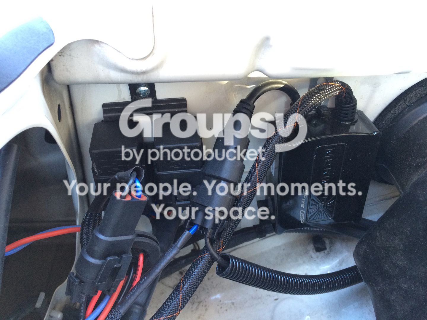

Here is a view of the relays mounted behind the passenger head light and before the air intake port on the passenger side inner fender well...
overhead view of previous pictured relays and ballast

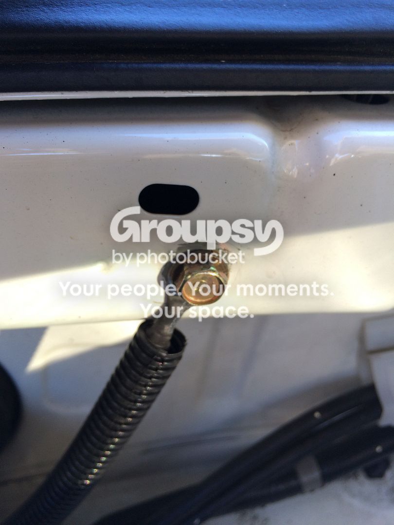

picture of the ground right after the passenger side air intake port on the passenger side inner fender well. The picture does not show it real well but I sanded down to bare metal where the metal eyelet contacts the body

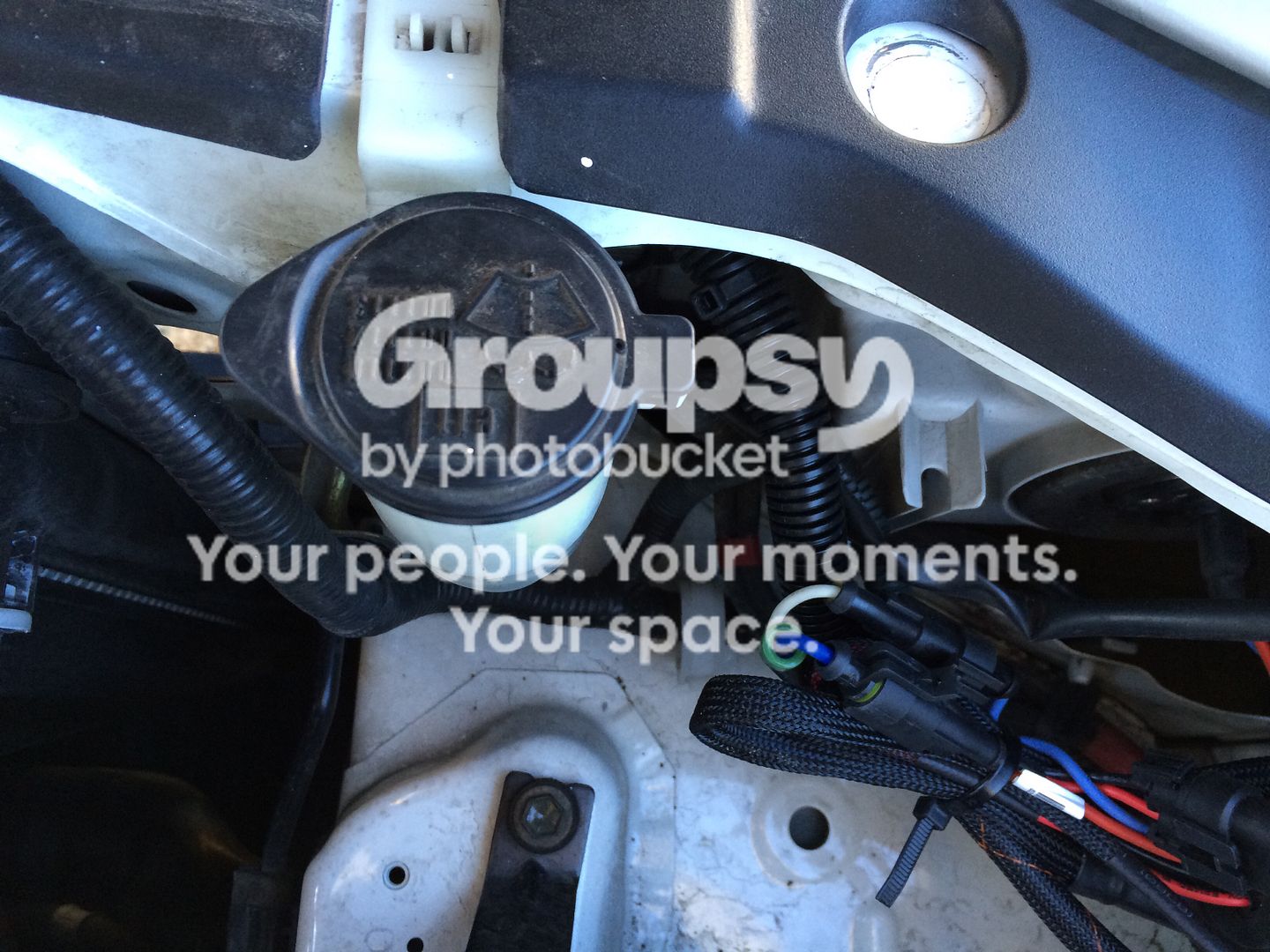

Here is a picture on the drivers side of the runner next to the head lamp housing where the wires route through the core support and go back behind the head lamp housing. I covered the wiring with convoluted tubing and zip tied to the a/c tubes that go to the condenser. The wiring includes a fuse which I have checked and is great.
Here is my new battery pictured and the wires behind the head lamp housing. The ground I used on this side is down on the back side of the core support below the condenser hose.

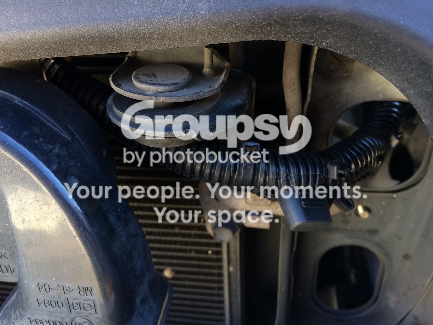

Here is a picture of the ground behind the core support below the a/c line

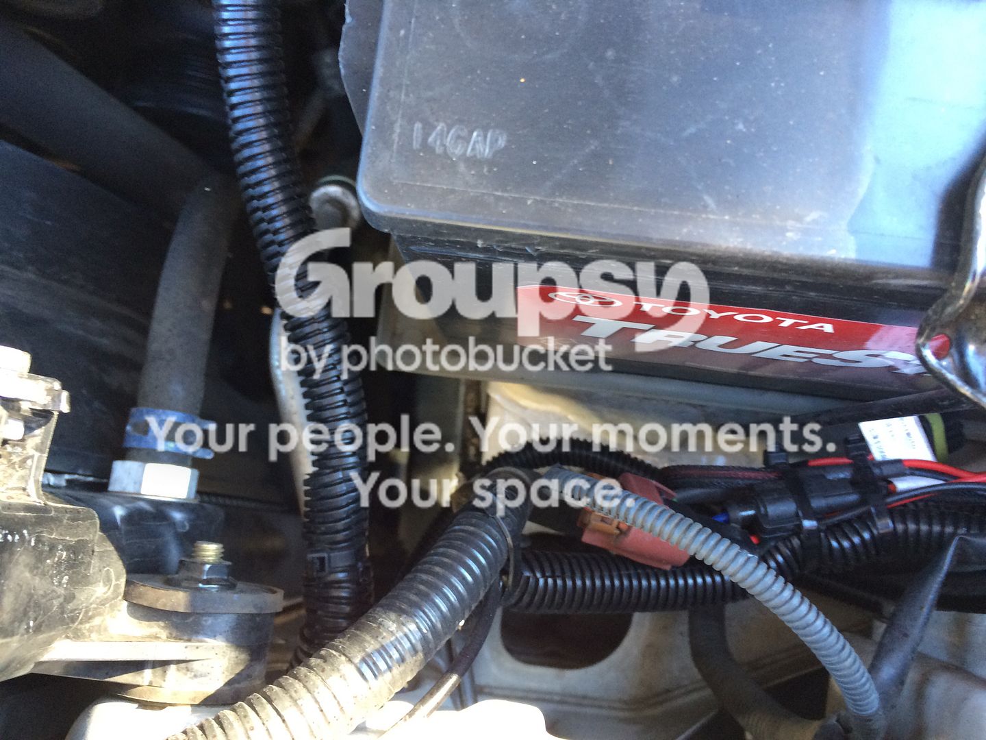

Don't know if this impacts it but this is where the system ties into the power source?? The metal below the eyelet is not covered with the battery spray.

First off that's a fancy HID kit, the logo is EMBOSSED on the housing AND its BLACK?! WOAH! :O All the HID kits I see are the EBay Cracker Jack box ones with the blue cellophane still stuck to the ballasts that are barely zip-tied!

How tight is that positive terminal/eyelet? Is it possible you got some battery protector between the layers of connectors? (By the way, that connection looks fine and perfectly good.)
