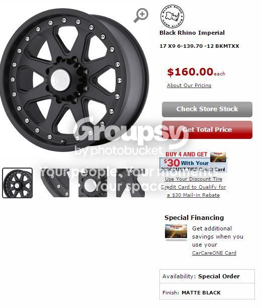

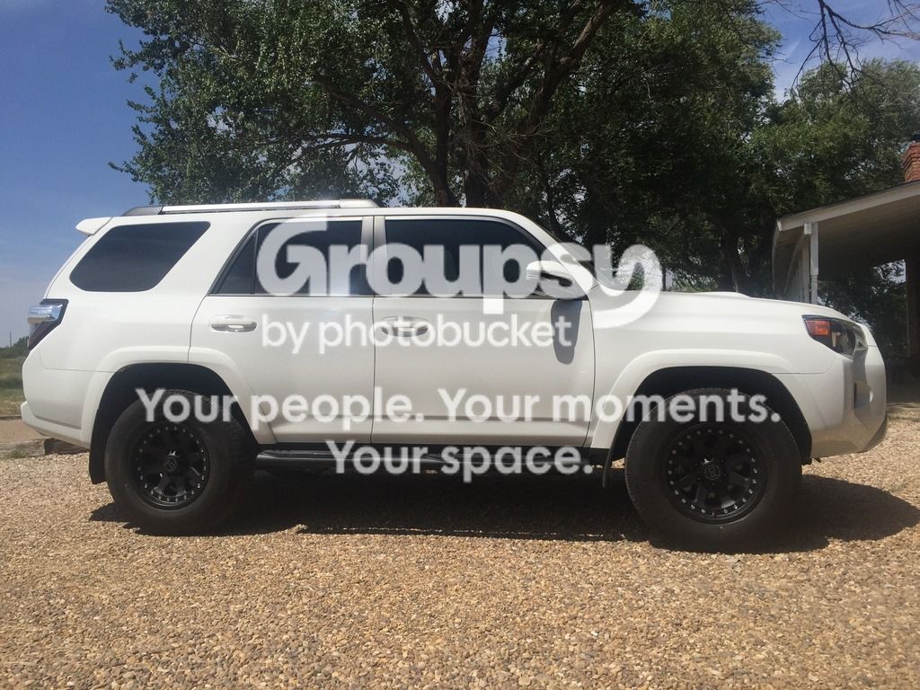

Thought I'd go ahead and start my first thread on T4R. I am going tomorrow to have wheels installed and will be adding 5100s all the way around (front set at 1.75") with a Cornfed 1" spacer in the rear this weekend.
Have had my 4R for exactly a month and these mods are about as far as I'm going to go for now. I will add tires in the next few months after I get a good idea of where she sits with the new wheels and lift. Also plan on plastidipping the front emblem and silver bumper inserts black.

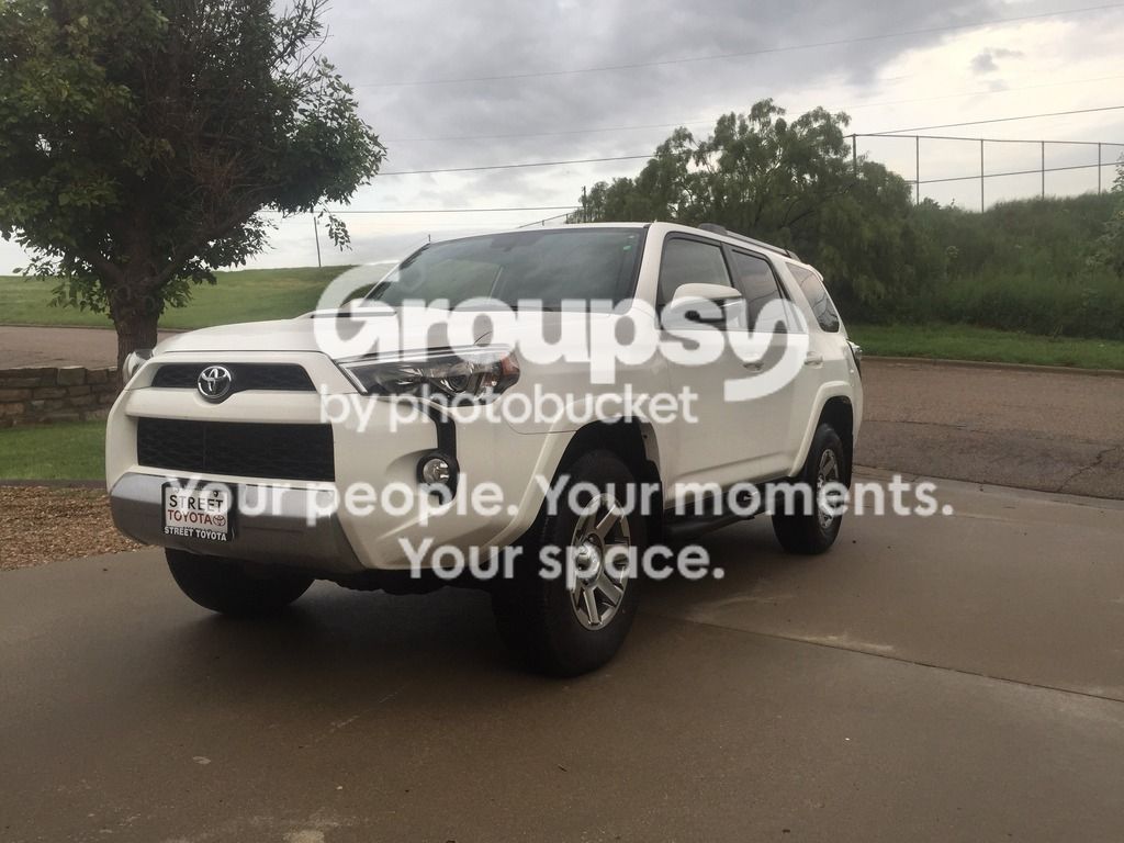

As it currently sits:
Wheels going on tomorrow:

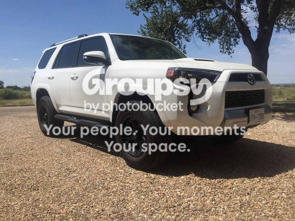

Truck is dirty but I got the wheels on! Tires will be added as soon as i figure out what the lift will bring the stance to.
5100s and Cornfed 1" rear spacer arrived today. Cornfed and Total Automotive Performance were great! Fast shipping. Install is Sunday.

No KDSS, and me and a couple buddies are installing it at my buddy's shop today....he has a lift thank God :whoo:

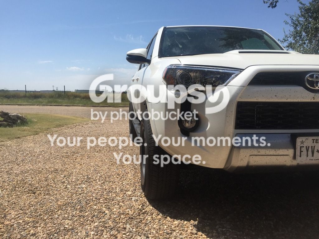

Just got the shocks on today, no spacer. Ended up setting them at 1.75"

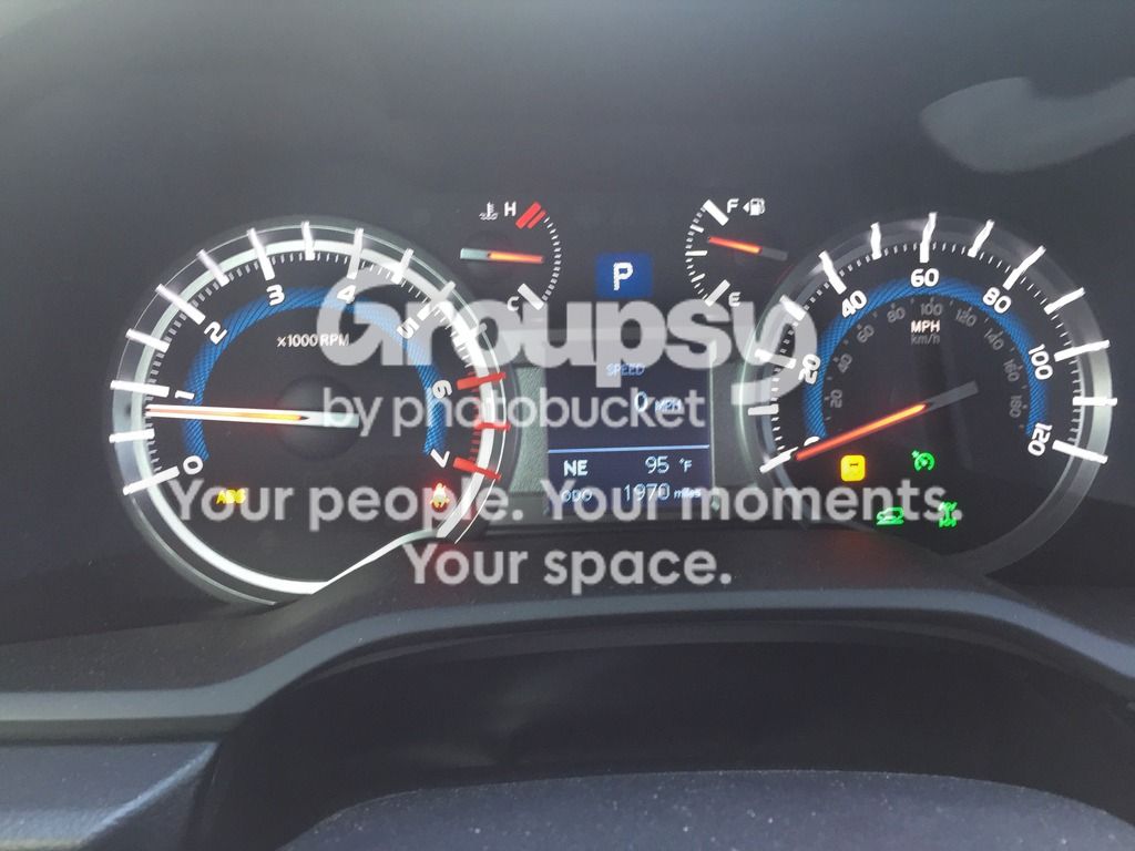

However now my dash is lit up like a Christmas tree. I saw the Zero Point Callibration thread and tryed the process a couple times. Going to try again in the morning and if I can't figure it out I am going to call the dealership to see if they'll reset everything...
The zero point cal. won't fix those dash lights. It looks like you stretched an ABS sensor wire (haven't installed my lift myself, but apparently it's very easy to do). You'll just need to replace that on the side you stretched and you'll be good to go.

It will fix all 4 lights?
It more than likely will. Takes a bit of driving for the computer to recognize that all is good, but it's a common issue. Just search "ABS sensor wire 5th gen" at the top and you'll see a bunch of threads on the matter. It should be about $50 for the harness.

Thanks guys, appreciate it. And the first side we did I thought we put a little too much stress on the wire. Thanks again!

yes, there is not much slack on the abs line, I did a suspension install and I disconnected the top bracket so it gave it some more line.
